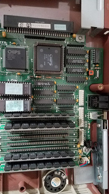

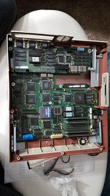

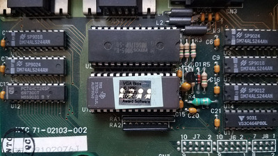

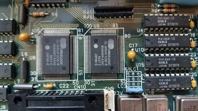

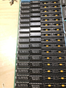

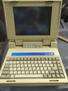

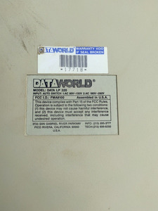

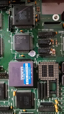

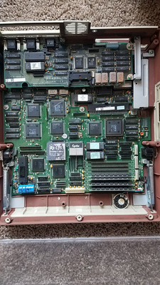

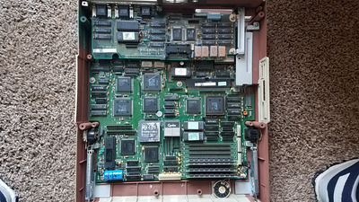

I just got my super cool DataWorld LP 320 Laptop.
I can't find any screenshots online of the motherboard or dim switch settings.
This thing has an ISA slot - 8bit and I want to install a sound card.
I currently have a Sound Blaster 8bit sounds card but it's too long if anyone has an 8bit sound card that is sound blaster compatible I'd love to trade with you.
Here are some pics before I installed the cpu and mathco.
Still waiting for memory to get here.

Reply 2 of 14, by DerBaum
trojan2179 wrote on 2023-11-06, 23:41:
How do I share photo's
just upoload them here...
(drag the pictures into the text box of the "full editor")
either you can just upload the picture or click on the paperclip next to the picture to make it appear on a specific place

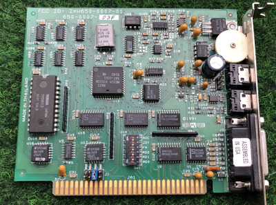

short sound card for example: Mediavision thunderboard
1.88 MiB
573 views
It sounds ok and is really quite small...

Reply 3 of 14, by trojan2179
That sound card would fit thank you.
There's one on ebay but it's too expensive.
Thank you for the help

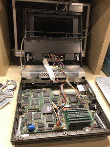

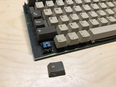

Reply 4 of 14, by DerBaum
That thing looks familiar...
But i wasnt that lucky with the condition it arrived here...
On my model the bios Battery has leaked, but it was fixable... Now the graphics card has bad ram (i guess), and the LCD panel is broken...
(RIFA in the power supply also exploded)
My Model is branded "Highscreen Laptop8100"
1.84 MiB
508 views
1.51 MiB
508 views
The best thing is the keyboard. Cherry MX Blue in my model.
1.29 MiB
508 views
The Mediavision was planned for it but now i will use the Laptop as spare parts and use the soundcard in another build.

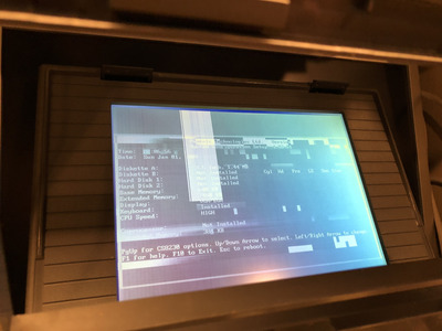

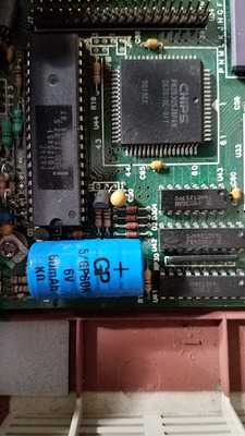

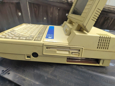

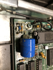

Reply 6 of 14, by trojan2179
I might buy one of these adlib repro cards but I do like the Mediavision thunderboard they say the sound blaster output is pretty good.

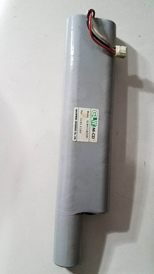

May backlight is out but I get an image
Nickel battery leaked but missed the motherboard.
CMOS battery hasn't leaked.

Reply 8 of 14, by DerBaum
trojan2179 wrote on 2023-11-07, 20:09:
1. Is that aztek Sound blaster compatible?
2. Is it for sale?
1. Yes
2. No ... at least not mine. They come up on Auction sites from time to time.
I would give you the dark case for free but its not in good shape. Hinges are broken and port covers are missing. I have no accessories like the external Floppy or the numpad.
And i also think the shipping cost would be not worth it.

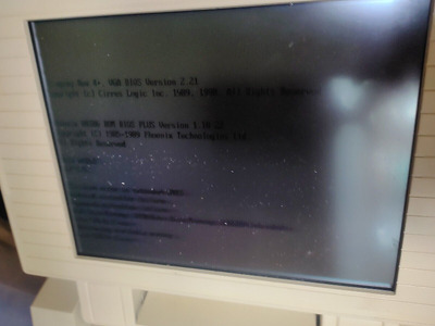

On my screen the backlight is working but parts of the display stay white and others flicker...
1.55 MiB
440 views
The corruptions are from the bad video memory (i think)...

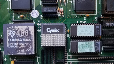

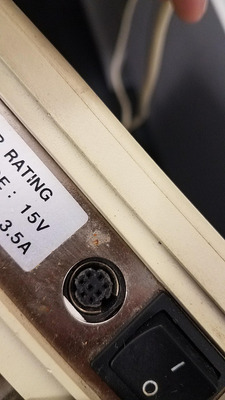

Reply 12 of 14, by DerBaum
trojan2179 wrote on 2023-11-08, 19:16:
BTW do you know what the dim switches do in the back of the machine?
Thank ya.
The DIP switches should be for the graphics card... either to set the internal display type or the external... i dont remember exactly.
Dip switch 7 and 8 are up, all others down when its original.
FCKGW-RHQQ2
Reply 13 of 14, by trojan2179
Here's the TI Tx486 DLC 40MHz CPU and Cyrix 40mhz Math Co
Reply 14 of 14, by Tiido
I see corrosion at the battery, this will have to be dealth with or sooner or later the machine will need significant repairs.
