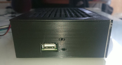

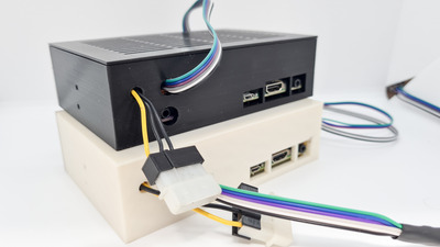

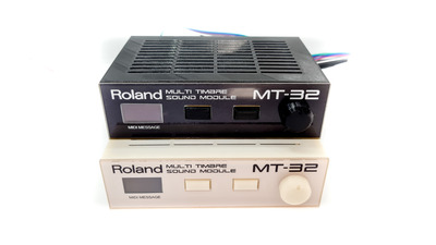

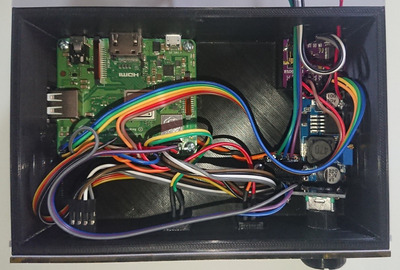

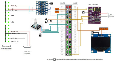

Reply 74 of 84, by K-rnivoro
Hope you like mine for internal 5.25 bay. Either in black or "beige" for older cases. Oh, you do not need the MIDI cable!!! It´s connected directly to Waveblaster pins of the soundcard. I´m planning to publish .stl and .ai files in case someone wanted to build it. Just le me know.
    111.89 KiB
    504 views
    875.67 KiB
    889 views
    1.03 MiB
    891 views
    294.99 KiB
    897 views
    152.83 KiB
    897 views
