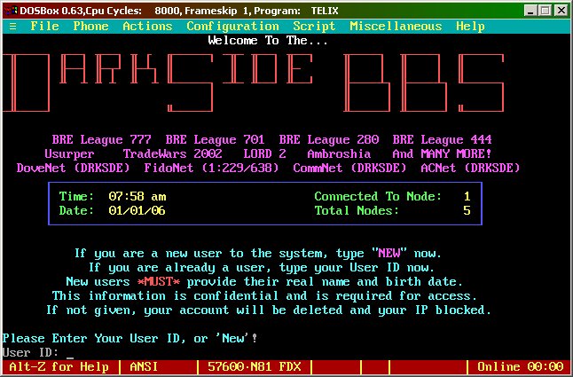

Hi, I am running Debian Linux (testing version) and I have installed Dosbox v0.63. I have installed the shareware version of Telix and I set up a Telix dialing directory for a BBS I like to telnet into.
Here is what the console messages produced by Dosbox look like when I run Telix and attempt to "dial in" to the bbs:
Modem Sent Command: ATZ […]
Sending OK
Modem Sent Command: ATDT65.185.171.55host 65.185.171.55 port 17
It never connects. After this Dosbox stops receiving any AT commands.
And by that I mean any and all AT commands sent from Telix produce no messages in the console.
I restarted Dosbox, and added ATNET1 to Telix's init string so that the init string is "ATZ^M~~ATNET1^M". Now my console messages look like
this:
Sending OK
Modem Sent Command: ATNET1Unhandled cmd N0
Unhandled cmd 10
Sending OK
and then the console stops producing message same as above.
I searched the forums for "telix" and that's where I found out about using ATNET1. The messages were from Feb of 2004 so I assumed it would be in v0.63.
From a linux console and I can telnet into this bbs just fine.
Has anyone else gotten Telix to work with Dosbox?
