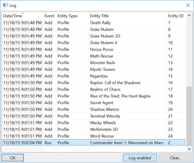

Hi all,
Another test build 0.79i is ready with the following changes:
* Implemented alternative DOSBox startup mode for both Linux and Mac OS X which should help when using for example YKHWong's Daum builds (Lewis);
* Added basic event logging and a new log dialog (File->Log..) to view the log, sort it, filter it (right-click on a table field), enable or disable it, or clear the log;
I've also received a report that DBGL on Linux might crash when using an older version of KDE, specifically using the library gtk2-theme-oxygen. If you're experiencing these problems, either use a different theme for GTK2, or try to update gtk2-theme-oxygen to 1.4.6 or later.
This will be the last test build, unless any serious issues pop up. If anybody is planning to work on updating a translation, please do so now as I will most likely release 0.80 next week.

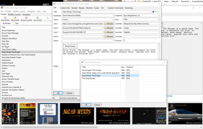

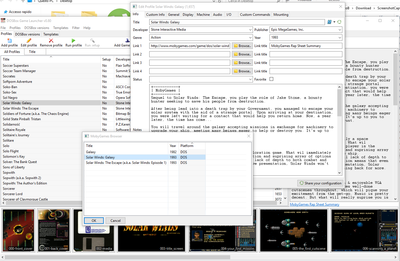

This issue doesn't allow me to sleep...
I need to tell you about this low level problem about MobyGames query module, consider (for example) these two games:
Solar Winds: Galaxy
Solar Winds: The Escape
As you can see in the attached images:
if I edit "Galaxy" profile and then query MobyGames I only see the "aka" name for "The Escape" profile
if I edit "The Escape" profile and then query MobyGames I only see the "aka" name for "Galaxy" profile
266.45 KiB
9453 views
272.05 KiB
9453 views
In my case, this happens a lot of times but I'm able to find a common denominator 🙁
