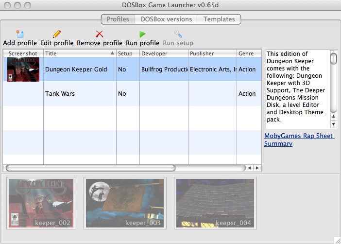

I am also attaching new pics of the screen spacing. It does look better than it did before. Thanks for that. I do have 3 suggestions on how to optimize space further:
Could the dead space be removed under the link section? this would give the description more room to fill. Could the menu disappear in a way that could be used up by text (like it does in the profiles columns box)? Can the profile columns box only expand to the maximum space they are allotted, so the description will take the room up instead of it being used for empty column space?

As for the spacing/layout: DBGL stores visible columns, column widths, column names, column order, screenshot heights, window sizes and the sashbar location in the middle of the main screen, so I don't really see the problem here. I've removed the dead space under the links for it to be used by the notes box, like you suggested.

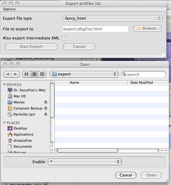

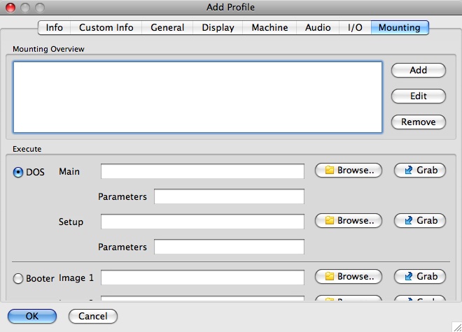

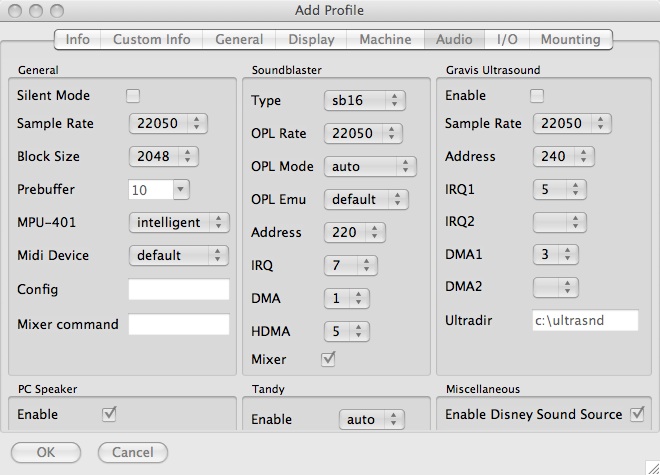

I wanted to point out the default spacing on the add/edit box. In both of these cases, the default spacing has cut off the bottom of the options. In the case of the audio configuration, there is no hint that there might be more options.
I also wanted to note that when I try to use the browse button in the export box, it brings me to a menu where I am unable to select a file name to save it as. It looks more like I am trying to open a file than save one.
On a further note, I am unsure if I am able to get the migrate, export and import to work properly. (this may just be me, as you know, I sometimes have a hard time getting things to work)
In the export when it asks me if I want to view it, it opens it up in my html editor. Is it possible for it to open it in my default web browser instead of the default program associated with the file?
When I go to import a profile, I need to select a configuration file (not the file I just exported...?) but I can not jump into the OSX bundled applications with the browser bar. When I do select a file, & hit import, it does not tell me if it did in fact import the settings.
In the Migration profile, it does not matter what directory I select (be it my movies folder or what not) when I hit the migrate button, a box comes up saying "Migration completed successfully.".
I think there might be something up here, but I will not discount the possibility of my not being able to work it 😀
Reply 551 of 1700, by rcblanke
Thank you drsassafras, the default window sizes are slightly enlarged so that everything fits. Also, the save file dialog was fixed.
