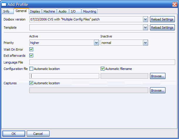

Reply 79 of 1696, by rcblanke
collector wrote:
...One thing that I'd like is the option to save and use the conf file in the game's directory, not just the profiles folder of DBGL...
Yes, more people have asked for this feature so I'm planning on implementing it. Unfortunately, this change requires a database structure change which I would like to avoid as much as possible in coming versions! Therefore, I'm asking your opinion about the approach I took so far:
The settings dialog will get three new options for setting default profile options (see screenshot). Those settings are also available in the 'add profile' window. Automatic is the current behaviour using a subdir inside DBGL and an ID for the config filename and captures path. Deselecting 'auto' makes the field under the checkbox editable. In case a user leaves the field nonauto and empty, the game's directory is used. In case the filename field is left empty, the title of the profile will be used (stripping special characters like /, *, ?, etc. to be able to store it on the filesystem).
Please let me know if I'm missing some (underlying) functionality. Also, if you can think of a way to improve the interface tell me, because frankly, I think it is not very intuitive at the moment but couldn't think of something better 😒
Regards,
Ronald
