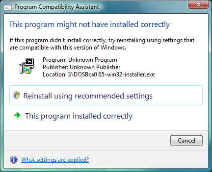

As a side note, when I ran the rc1 installer in vista, a box popped up saying that the application may not have installed properly, and asked if I wanted to re-install using the recommended compatibility settings. The installer failed to create a desktop shortcut, but otherwise seems o.k.

0.71rc1 installer doesn't install a thing to the desktop.
The warning is unfortunate though. Would have to track down which part of the installer causes the warning.
Did 0.70 installer such a warning as well ?

I think that the win 9x / win Nt detection command might cause the error flag. (added in 0.70)

Qbix,
I tried installing 0.65 and got the same message

Reply 39 of 41, by Reckless
I believe that error dialog is presented for DOSBox as (AFAIK) it does not add an Uninstall key to the system. I don't really understand why the team decided DOSBox didn't need an uninstall option...
There might be ways of getting around it using the current installer product - I don't know personally as I only develop MSI's myself 😀 You could always flip to an MSI using the WiX toolset - very easy... though I'm sure you've got better things to do 😉
