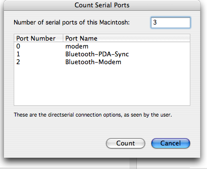

Reply 38 of 52, by IIGS_User
darkgamorck wrote:
0.72 will be out sooner rather than later and direct serial for OS X will be part of it.
How to use the directserial connection in MacOS X?
When I try the unix grammar
Serial1=directserial realport:ttyS01
the Terminal replies with
Serial1:Serial Port "/dev/ttyS01" could not be opened.
The specified port does not exist.
What values do I have to enter next to "realport:"?
    27.45 KiB
    583 views
    The ports my Macintosh offers.
