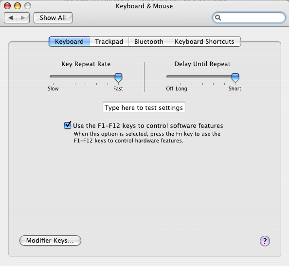

I have one remaining issue that I'm trying hard to solve: My application uses the F10 key all the time. And on the iMac, with System Preferences for the Keyboard and Mouse set so that the box is checked for the Function Keys to act as "standard keys", all the keys F1 through F9 work properly, but F10 does not. F10 dims the screen instead. In order to get the F10 key to work as the F10 key, the Command key must be held down at the same time. Anyone have any suggestions for correcting this?

Reply 43 of 52, by InstantWare
Hal,
Did you really set the correct switch in the keyboard control panel (s. my screenshot)?
Best regards
Rolf
    48.88 KiB
    781 views

Reply 45 of 52, by hsegal
Rolf,
Yep, I do have that box checked, and the function keys work fine for F1 through F9, but for F10 to work I still need to hold down the COMMAND key when I press F10, which is a pain when done a hundred times a day.

Reply 46 of 52, by InstantWare
Have also a look in the Dashbord & Exposé Settings, those also used to occupy F-Keys.
The mapper as suggested by wd helps only to map F10 to another function key. For example you can map F6 to have the function of F10 within dosbox.
This would be of course only useful for you if there is an unused or seldom used F-Key in your program, which you can then use instead of F10.
Best regards
Rolf

Reply 48 of 52, by hsegal
SUCCESS! Using Rolf's brilliant idea of just assigning another key on the keyboard to use, it worked. I just made another key do the functionality of F10. This got around my inability in mapper to use the Mac COMMAND key as a modifier, which seemed necessary to get the F10 to actually function as an F10. Thanks Rolf, for your insight; and thanks wd for pointing me in the right direction so that I could set up mapper.
