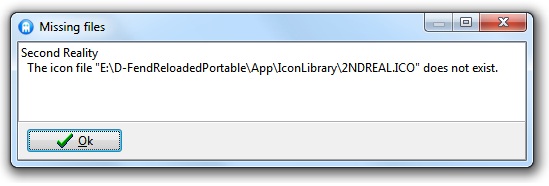

Reply 1352 of 2280, by sst
Hi, ... Alexander
I use your = D-Fend Reloaded, "1.0.2rc1", D-Fend Reloaded PortableApps package".
Second Reality = Missing Icon
See file attached
Second Reality demo, is downloaded inside "Packages manager | Games" tab.
    27.14 KiB
    3095 views
Reply 1354 of 2280, by Alexander
Hi sst,
thank you for your updated language files.
The auto setup template for Second Reality defines an icon for the profile. The big demos package from the D-Fend Reloaded homepage also contains this icon so every thing is fine when using this package. When downloading Second Reality via the package manager a zip file is downloaded from scene.org. This zip file is a plain zip file just containing Second Reality without any DFR profile file or any icon. Because DFR detects by an exe checksum the zip file contains Second Reality it applies the Second Reality auto setup template - which has the icon record. D-Fend Reloaded 1.0.2 in this case will check if the icon file exists and remove the icon entry if not.
