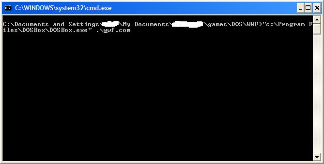

Reply 11 of 17, by lwc
Qbix wrote:
you are using a bit different from most people 😀
I just run the defaults. How are the defaults not the default way?
maybe read up on the -userconf parameter
The manual neither defines "user's specific configuration file" (it originally misses a ') nor explains what happens without it. In actuality, not using it just uses the default config (i.e. in the profile's folder) plus the local one.
robertmo wrote:
how EXACTLY do you start a game (you click on what? or what do you do?)?
I create a shortcut for the aforementioned command or run it from the command prompt.

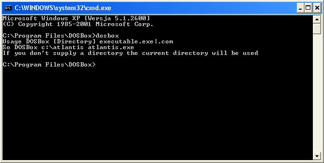

Reply 12 of 17, by robertmo
lwc wrote:
The manual .... "user's specific configuration file" ... nor explains what happens without it. In actuality, not using it just uses the default config (i.e. in the profile's folder) plus the local one.
Manual explains it all. Read it! And than post.

Reply 15 of 17, by robertmo
Why? 😉

Reply 16 of 17, by lwc
I don't understand your cynicism. If you provided any information here, I'd be happy to write a page about it in the Wiki, like I did many times in the past.

Reply 17 of 17, by robertmo
i wonder what can you write in the wiki if you don't even know what is in the official manual...
have you red the:
13. The configuration (options) file:
in the manual first and is there anything you don't understand?
I used the same command as you and in both dosbox's (0.73 and 0.74) it works exactly the same. Always properly as described in the manual.
