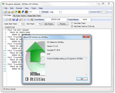

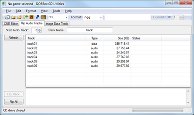

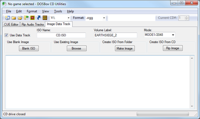

A few years back I started writing a tool that was a frontend for CDRTools that could could rip/compress CDA tracks and make ISOs of CDs, and generate/edit CUE sheets for DOSBox. It was also a simple frontend for DOSBox. I gave it up since there was not much interest in it.
