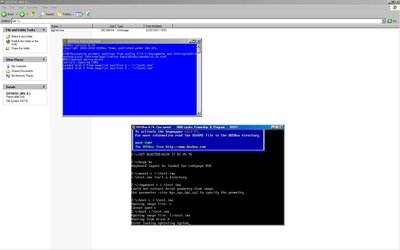

Machine: SD card boot (SD on E:) success!
Machine: floppy boot success!
DosBox: boot -l e: fail!
DosBox: boot (DosbBox engages floppy) fail!

Reply 10 of 12, by Phoebus1966
Who said there is no geometry involved, I hope it wasn't one of the developers.
Sure there's a geometry since DosBox reports on it.
I used WinImage to create the image of a 1GB SD via USB stick with MSDOS on it. This 1GB SD via USB stick boots and everything from BIOS on a machine.
It is strange DosBox cannot by itself extract the geometry. Is WinImage that exotic 😉?

Reply 11 of 12, by Joey_sw
Most software that creates a imagefiles would usually also spit out the image supposedly geomety, but...
there case where such geometry aren't adhere to IBM PC's Int 13h specification/limitation.
- Can only have max 63 sectors per cylinder,
- Can only have max 1024 cylinders per head,
- Can only have max 255 heads
If the image hasn't contain any useful information yet (ie unformatted), AND its capacity is acceptable for INT 13h (no more than 8,422,686,720 (512 x 63 x 1024 x 255) bytes),
you can work it around by re-arranging its geometry values.
For example you can look for common divisor value between the heads & cylinders, and apply them so the geometry would fit for INT 13h limitation, while still maintaining the same overall values (sectors x cylinders x heads).
IMPORTANT: The above workaround are NOT advisable for image files that already contain data, as such rearrangement may changes the logical sectors numbering.

Reply 12 of 12, by Jorpho
I do not use WinImage, so I'm not sure how you could get geometry data from there. But as Dominus suggested, autodetection of geometry is apparently a feature included in SVN builds of DOSBox.
