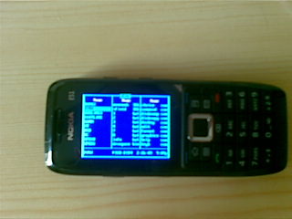

Reply 145 of 197, by greenender
GOOD TIP FOR EVERYONE:
Get Norton Commander. Configure it, to display left panel only, half size.
Copy NC to your phone, change dosbox.conf to run NC automatically and set oversize=page. NC is now fully readable, and the panel is shown perfectly on the screen. Look for my attachment 😀
    17.64 KiB
    8924 views
