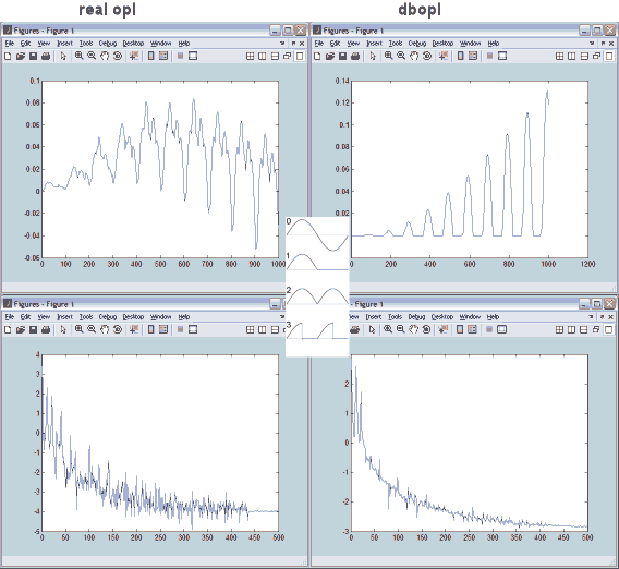

wd, though I'm not a DAC expert, I have some experience in sound and other digital signal processing. The kind of artifacts I'd expect from DAC would be inaccuracies near the Nyquist frequency. Assuming the analogic circuits down the way don't have an optimal bandwidth, you'd get phase shifts and equalizer-like effects, but no distortions like you have here.
Edit : it's also possilbe that the SB DAC doesn't have a linear response. It could explain why the original has more dynamics (in my ears, at least).
Edit2: I found some documentation about the Adlib/SB DAC (YM3014B). You most probably already know about it, but here it is, just in case. It was always used with the OPL-2 in 8bit cards. It consumes 13bit floats (10bit mantissa + 3bit base 2 exponent). The DAC operates on the 10bit part only, the exponent is then applied by analogic circuits.
Edit 3: While I'm at it, here is the OPL3 DAC datasheet. It's basically a 2 identical to the OPL2 one, except it has 2 channels.
Edit4 : Looking at the 1000 first samples of both sweeps reveals other things that can't be DAC-related.
The real OPL uses a "mode 2" wave, with some added harmonics. dbopl uses a pure "mode 1" wave.
The pictures are nice, but useless without any explanation. If you're after
the DC shift, that's been verified to not contribute to the audible quality
but is notably visible in wave editors.
I don't know what further processing the sb cards perform with the digital signal
besides the DAC one, but for me they're all DA (or AA) transformations.
Afaict none of the effects is modeled in dosbox.

The pictures are nice, but useless without any explanation. If you're after the DC shift, that's been verified to not contribute […]
The "DC" shift, in this case, is a 15-20Hz wave, at the lower limit of the human listening capacities. This could indeed be induced by the analogic circuits.
If you make abstraction of that slow wave, the original sweep can be described as a rectified sine wave with some harmonics of the same kind. The DOSBox one is a pure truncated sine wave of twice the frequency.
I can't see how you could cleanly transform a truncated sine wave to a rectified sinewave of 1/2 it's frequency with simple analogic circuits. Assuming you have that kind of filter, it would distort all samples in a similiar fashion. You can add harmonics in analogic circuits by overdriving them. But 1) you won't get nice rectified sines like you have here (or are these sines?). and 2) we are far from the overdrive point of the circuits (at 1 on the scale).
Both the truncated sine and the rectified sine being basic OPL oscillations, a DOSBox bug seems the most economic hypothesis explaining the problem.
I've checked a dro cap in Cozendey's emulator and that end-of-intro sounds
like in dosbox (he's also going up to the digital part only).
Reply 28 of 31, by Zorbid
Actually, I might be wrong... It turns out that the waves are mirror images of each other. The "real OPL" wave is a trucated sine with some added harmonics, and, now that I think of it, the abruptness of the truncation may induce some ringing...
You're most probably right... Sorry for bugging you all the afternoon.
