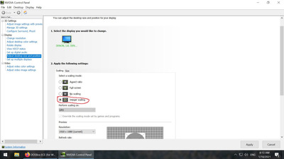

Reply 1229 of 1550, by Crimson_Zero
7F20 wrote on 2021-01-18, 16:07:
I'm not aware that video cards support arbitrary scaling. AFAIK, doing that would result in a 1600x1000 squished image (320x5, 2000x5).
Which brand card do use?
It's an Nvidia card. Here's the option in the control panel.
Without actually measuring, it looks correct to my eyes when running Lemmings in DOSBox with the black bars on both the top/bottom and sides in fullscreen mode.
Again, fullscreen=original must be set.
    149.92 KiB
    2292 views
Reply 1230 of 1550, by 7F20
Crimson_Zero wrote on 2021-01-18, 16:25:
Thanks.
I am familiar with the Nvidia integer scaling option. What I don't get is the output. It should be outputting either 320x200 or 320x400 from DOSBox, depending on what machine you choose.
The only way I can see what you are doing as "working" is if Lemmings is a 640x400 game, which I guess it could be because I don't know it. Then you would be getting a perfect 1280x800 with bard on the top and bottom as you say. If so, it wouldn't work for any game that outputs at 320x400 (or any other oddball resolution). It would output, but the shape of the screen would be off.
Also, just to be completely clear about it, even if everything works okay with the Nvidia card, the requirements for getting it to work are quite hefty. You have to have a 2000 series card with RTX or newer, it doesn't work on laptops unless there is no intel iGPU and you have to turn off a bunch of other features and manage the colorspace your monitor operates in just to get it to work. It's not exactly a universal solution.
Reply 1231 of 1550, by Crimson_Zero
7F20 wrote on 2021-01-18, 16:50:
Oh I agree. That's why I originally said to temporarily turn it on if your video card supports it. It isn't an everyday solution. My usual DOSBox setup is to go with the pixel_perfect.glsl. Simple, easy and works without putting too much strain on the computer. I was surprised to see that the shader did not give me the expected results in vgaonly mode though, so thought I'd test it with the GPU's scaler and see what happened!
