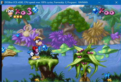

Hey all,
Another day, another issue, this time with the game Rayman.
On the latest version of ECE the game runs fine at first, I can navigate and change stuff in the menus, but when I start a new game, the game crashes, and takes with it my whole system.
Mouse cursor is frozen in place, there is a buzzing sound (last note played I guess), CTRL+ESC/ALT+Enter/ALT+Tab/CTRL+ALT+DEL do nothing, and pressing the power button turns off the PC immediately instead of initiating a graceful shutdown.
There are no errors in Windows logs.
I thought I'd leave this here in case someone wants to give it a whirl. I'll attach my config file.
DOSBox ECE 4380 running on Windows 10 x64

Reply 1157 of 1365, by Yesterplay80
I'm beginning to think that the issue is more likely your PC and its installation than DOSBox (ECE). At least I can run Rayman just fine with r4380.

Reply 1158 of 1365, by PoulpSquad
You are right YP, it was my configuration.
I just found what is wrong, SLI is messing things up with DOSBox. Euro Truck Simulator 2 exhibits the same problem.
Removing one video card, deleting video drivers with DDU, and installing the most recent drivers fixed the issue.
It is 100% replicable, thanks God. Adding the second video card immediately causes DOSBox to fail at the game selection screen.
Sorry for blaming DOSBox. If anything, it is helping me out in sorting problems I never knew I had^^
