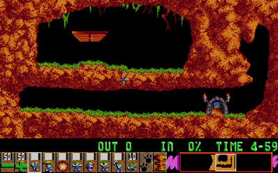

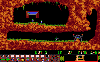

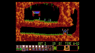

Quick question: can I achieve this in Dosbox ECE at this moment: scale a 640 x 400 game to a 1280 x 1000 resolution (resulting in "pixels" that are 2 by 2,5). I want to run Lemmings like this. Original resolution is 640 x 400, but you can see that the game itself already has pixels of 2 x 2 (see attachment "original").
With this patch: https://github.com/bladeSk/DOSBox-pixel-perfect I manage to get it as I want (pixels of 4x5): see attachment "Patch". Only problem is that this patch can nog handle the "vgaonly" option, needed to get the colors right.
Does Dosbox ECE has something to achieve the same: basically have nice, sharp 4x5 pixels for this game as seen in the screenshot?

Reply 1197 of 1365, by Ringding
TomVDJ wrote on 2021-01-14, 14:20:
640 x 400 would have been considered high resolution at that time, which Lemmings definitely was not. Is "640 x 400" not just an artifact of how DOSBox handles this internally?
Reply 1198 of 1365, by TomVDJ
Ringding wrote on 2021-01-14, 15:29:
You are right. It's 320 x 200. But when you use the "machine = vgaonly" parameter it shows as if the "original" resolution was 640 x 400. I have put vgaonly because this is the only one that renders the correct colors of the game. If I use "machine = svga_s3" the original resoltion indeed shows 320 x 200. However, the colors are way off. Also, only the game screen is 320 x 200. The title screen and level info screens are 640 x350. See attachments for all screens in original resolution (svga_s3). Also notice the ugly coloring in the level info screen and also in the buttons on the game screen.
I found this old thread about the doublescan issue with vgaonly: Double-height and double-width
Does the latest Dosbox ECE version still supports pixel perfect display (with pixels represented as sharp rectangles)?
