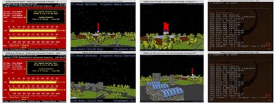

Reply 117 of 123, by krcroft
latalante wrote:
I tested the dosbox-staging version
Do you mean dosbox-staging as in: https://github.com/dreamer/dosbox-staging? (Your shell commands show DOSBox SVN).
latalante wrote:
... the results were clearly lower than my build.
"the results".. which results - realnc's posted above your post?
"my build".. compiler, version, and optimization flags did you use?
"clearly lower".. (lower being faster? or worse? and by how much?) - can you list the actual before-and-after/A-vs-B numeric results and units for the benchmark?
Reply 118 of 123, by latalante
krcroft wrote:
Do you mean dosbox-staging as in: https://github.com/dreamer/dosbox-staging? (Your shell commands shows DOSBox SVN).
Yes
krcroft wrote:
"my build".. what architecture, compiler, and optimization flags did you use?
This thread is for 64-bit architecture.
Look here.
64-bit dynamic_x86 (patch)
I use flto and others.
Lua, pcbench, lame, quake, ...
In each of my tests the difference was quite significant, at least 5-15% and maybe more. Maybe it's a matter of my old processor.
Reply 119 of 123, by krcroft
Thanks latalante, that helps.
I ran some tests and the two are roughly identical, within the noise of my system.
Can you try these steps? You can copy and paste them as-is into your shell.
Build the sources
wget https://github.com/dreamer/dosbox-staging/archive/master.tar.gz -O - | tar -zxC /dev/shm
wget http://source.dosbox.com/dosboxsvn.tgz -O - | tar -zxC /dev/shm
for d in dosbox dosbox-staging-master; do
cd "/dev/shm/$d"
./autogen.sh
export CFLAGS="-DNDEBUG -pipe -O3 -march=native -flto=$(nproc)"
./configure CXXFLAGS="$CFLAGS" LDFLAGS="$CFLAGS"
make -j$(nproc)
done
Install the benchmark
mkdir -p /dev/shm/dosbench
cd /dev/shm/dosbench
curl -sL https://www.philscomputerlab.com/uploads/3/7/2/3/37231621/dosbench_v_1.4_jan_2017.zip | busybox unzip -
Download the attached dosbox.conf and save it as-is into /dev/shm/dosbench
Benchmark Prep
1. Close all applications and confirm the system is idle
2. Open a new terminal
3. Lock your processor at its maximum frequency
echo performance | sudo tee /sys/devices/system/cpu/cpufreq/policy*/scaling_governor
echo 100 | sudo tee /sys/devices/system/cpu/intel_pstate/min_perf_pct
Benchmark
Launch each separately, ctrl+F9 when done, then run again.
../dosbox-staging-master/src/dosbox DOSBENCH.BAT
../dosbox/src/dosbox DOSBENCH.BAT
I ran:
- the landmark benchmark at 96400 DOSBox cycles (it wraps beyond that)
- the PC Player 3D benchmarks at default (low) and 640x480 resolutions
- Quake at default (low) resolution
510.78 KiB
1400 views
Curious if this changes anything for you.
