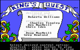

The game will work just fine, until you press TAB to bring up the inventory screen or talk to King Edward. Also, I forgot to mention but the title screen does not seem to display correctly in the Tandy mode (using the Tandy KQ1 disk image.) All the text seems to only display every other pixel column when it should be solid. The titles are barely legible and the names use two colors rather than one. Compare the title screen to the Tandy 1000 MESS driver and you will see the difference. I also note, however, that there are noticeable differences (n, t, b, d) in MESS's font compared to the true IBM 8x8 text font.

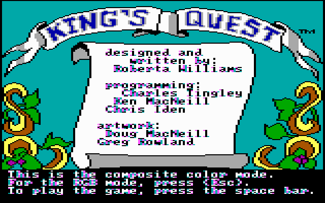

well I've been looking into the font thing myself fot the KQ1 booter in composite cga mode.
It gets some weird artifacts on the screen with text (red spots) I figured this is caused by our smooth fonts. So either I need to code a filter or add a different font for cga mode. Not sure yet which one to use.

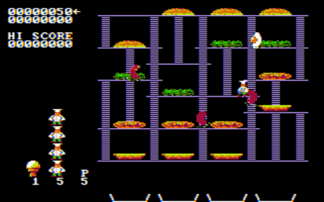

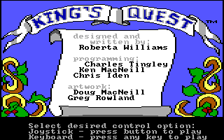

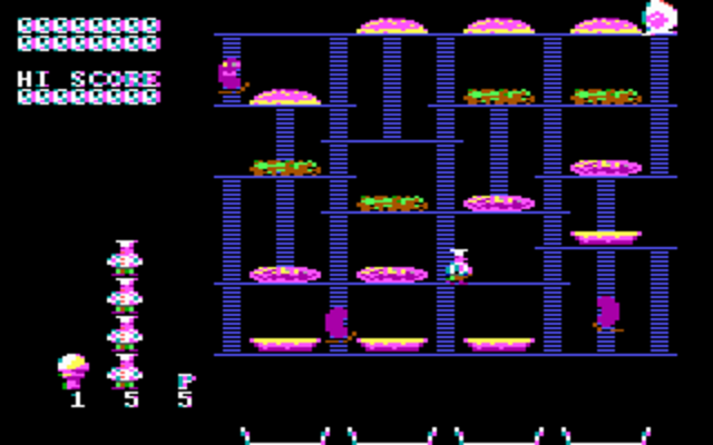

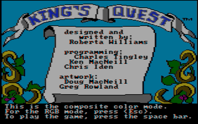

I've been in contact with the author.
I've implemented a similar algorithm although less advanged, because of restrictions in dosbox
This is a screenshot of the titlescreen. (cga composite mode)
The text is readable I would say.
This isn't in the cvs yet
    43.38 KiB
    12393 views
    burgertime new code
    43.67 KiB
    12393 views
    burgertime old code
    9.55 KiB
    12416 views
    0.63 code
    12.57 KiB
    12422 views
    kq1 (rescaled) new code (not yet in cvs)

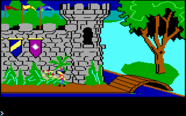

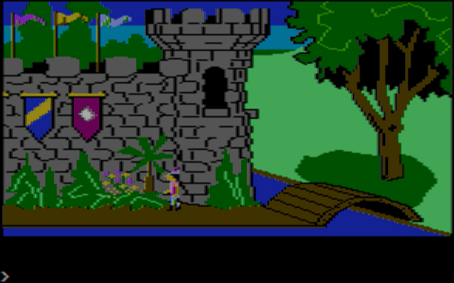

well it's not just text artifacts.
it's just anything that blends. We just interpreted the mode wrong
Must have been weird to code for it though.
Some more screenies
    60.72 KiB
    12384 views
    in game new code
    66.71 KiB
    12384 views
    current 0.63 code
