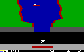

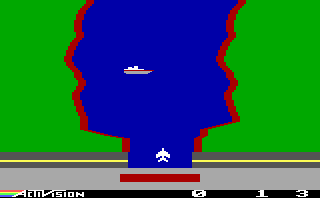

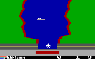

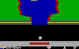

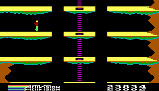

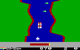

The entire screen 'jitters' when playing Activison's River Raid. The only time it stops 'jittering' is when you press forward on the controls (Accelerating the plane full speed ahead). It is especially noticable looking at your plane, fuel gauge and score area during game play.
Changing the values of any/all of the below options makes no changes to the problem:
fulldouble=
core=
scaler=
The "jittering" remains the same.
The same occurs with Pitfall II - The Lost Caverns. Screen scrolling vertically jitters (As seen in screenshot). Additionally, Harry himself "jitters" when running left or right.
-Trebor

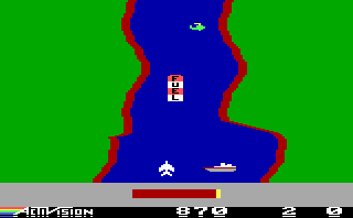

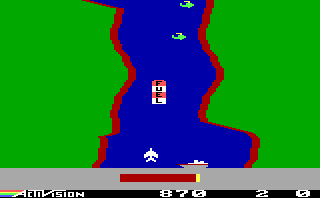

No other games "jitter", only these Activision titles. It appears more like the screen does not "update" properly when scrolling vertically, then anything else. Harry's "jittering" when running horizontally is not nearly as bad, and may have been present in the original game as well (It doesn't even become apparent until you're pass the "inital" screens and actual get to the multiple platform parts of the game). However, the 'score' area (Bottom 1/3-1/4th of the screen) is extremely noticable in both titles - but does not occur in Pitfall II unless the screen is scrolling vertically. Even at the beginning 'swimming' boards in Pitfall II, the part where you need to drop down and extra level (scene with the small waterfall to the upper left) to pick up one of the beginning gold bars (Electric Eel swims at the top), you can see the score section start to jittter then as well, but the screen is barely even moving vertically then.
Again, interestingly enough, if you press forward in River Raid (Full throttle ahead), there is *no* jittering - It completely stops. It is present if you fly at normal/default speed, or pull back to slow down your speed.

About the jittering: i think it occurs because of their kind of
scrolling routines, they copy screen parts and update the screen
assuming that all is done before it's actually displayed. It can
be corrected by adjusting the cycles, but as you said it appears
again if you accelerate/brake. They don't revector any interrupts,
i just found a vret adjustment and some joystick polling. No idea
what's going wrong with their scroller, sorry.

The jittering does not occur if you press forward (accelerate) - It stops. The jittering occurs when you coast at normal speed or pull back (brake).
I would love to see your *.conf file, if you could please post it. As well as the debugger version of DosBox where it does not jitter. I have tried values as high as 1000 (Game plays extremely fast) and as low as 50 (Game play extremely slow), the jittering remains present with every value. After the 1000 cycles, I would decrease by 50 (I.E. 950, 900, 850, and so on). The overall gameplay speed as well as jitter speed changes, but the same jittering problem remains, just at the speed of the scrolling (IE. Value 1000 has super fast game play with super fast jittering. Value 50, very slow game play, with very slow jittering).
My results have been that jittering is always present regardless of cycle value. It only changes in speed frequency. The faster the game scrolls, the faster the jittering. The slower the game scrolls, the slower the jittering. Again, the only time jittering stops is if you press forward; Cruising at normal speed or pulling back causes jittering, regardless of cycle value.
Interestingly, although the jittering does stop when pressing forward on the joystick (Acelerating), it always has the corrupt looking display when there is no jittering (Screen shots boot_004.png & boot_002.png from my original post - where there's an imprint of what the last scanline would look like if the graphics were not shifted a scanline up on the display). The clean looking screens (Screen shots boot_003.png & boot_001.png), never show if the screen is not jittering.

When the joystick isn't touched, the airplane will fly half of the screen
and the game stops then until some button/direction is pressed. This
short part has jittering of the plane/status info at the bottom of the
screen only when the cycles are too high (greater than 500) or too
low (less than 400).
> are you still experiencing jittering thoughout the rest of the game?
Yes, i didn't notice it before because the gameplay didn't start as i had
no joystick attached. With the cycles at 500 it jitters when
accelerating/braking the plane. When just flying, it doesn't jitter with
cycles at 500.
