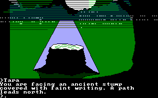

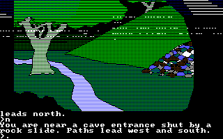

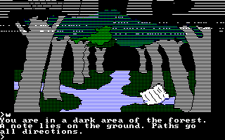

While playing Transylvania with DosBox 0.65 mode=pcjr, the top portion of the display becomes corrupted when switching between seeing the graphics or seeing your location/previous movements (Don't type anything just Hit Enter).
This does not happen if the game is set to CGA mode, and render options has no impact in the display corruption results.
-Trebor

Reply 6 of 8, by trebor
Double Confirmed...🤣
Thanks, wd!!!
You're the man!!!
FYI...Same problem/fix for The Crimson Crown (Transylvania II). Both games play/work beautifully now!
Thanks again. I really appreciate the responses and especially the fix.
-Trebor
Reply 7 of 8, by wd
Rank DOSBox Author
DOSBox Author
The memory layout for the machine=pcjr is a bit odd, but works for
a wide range of games (sierra ones that need a lot of memory,
some others only work if the memory is rather small).
Thus loadfix is always a nice thing to try, especially different values
as parameter.
