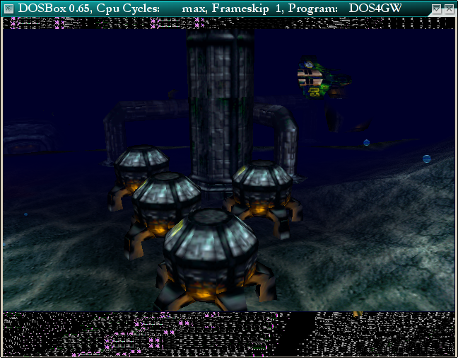

Okay, here are some Screenshots 😉
BTW, someone who is capable might want to split this thread, since the problem turned out to be not related to glide at all. Although the rendering errors, the missing HUD foremost, is a severe problem, the game is unplayable this way.
    346.48 KiB
    958 views
    True 3D models that are just sprites in the software renderer.

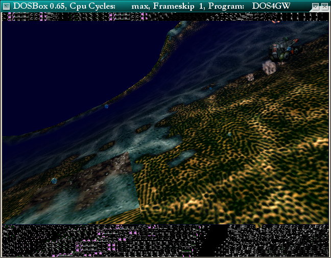

    464.03 KiB
    958 views
    Sprites with transparency.

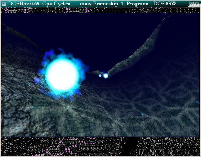

    391.06 KiB
    958 views
    Shooting, and buggy fog.

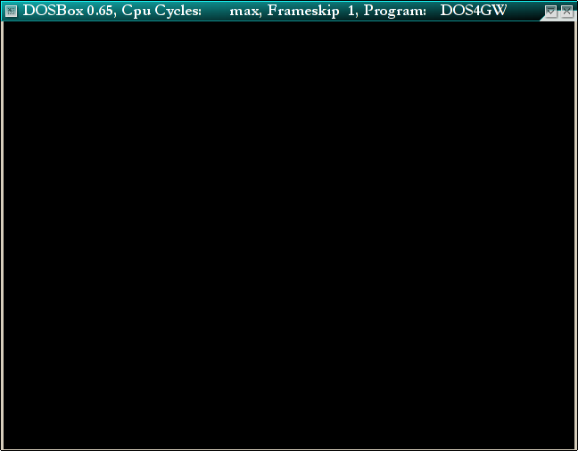

    15.32 KiB
    958 views
    Very clean look of the briefing screen, optimized for good overview ;)
