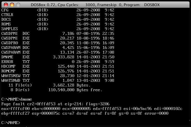

I would make a DOS environment with a front end (Game Launcher) to run Mame, with a view to making a cabinet eventually. I don't want to run Windows.
While setting up the DOS environment I was going to use mame through DOSBox on Windows, Mac and Linux since I have several machines with different OS's to develop the mame environment.
Things were going well, I installed and customised DOSBox on all platforms and had set up a test DOS mame install with a few test roms, everything ran fine with the Windows version of DOSBox, the same test mame environment crashed when running on the Mac version of DOSBox.
c:\dmame
Page fault cr2=0fffdf53 at eip=214; flags=3206
eax=ffffcf00 ebx=c0000000 ecx=00000005 edx=ffffdf53 esi=00a9ac96 edi=0000102c
ebp=ffffcf27 esp=0000075c cs=a7 ds=af es=af fs=8f gs=0 ss=8f error=0000
Are there compatibility issues between version 0.72 of DOSBox for the Mac and the same version for the PC? Is this a rendering issue?

DMAME 0.63. Also happens with many others including Advanced Mame for DOS, i586/686 variants
# Description of problem (be detailed: saying "it's jerky" doesn't help, saying "the player sprites seem to be jerky when I'm pressing any of the arrow keys" does)
DMAME crashes the Mac version of DOSBox, but works fine on the Windows Version of DOSBox.
# Reproducibility of problem (always, only once, always but only on a specific level, etc.)
Crashes every time, even with no arguments.

Read the readme. Tried many different versions of Mame for DOS, Windows DOSBox runs them all, the Mac version of DOSBox crashes with them all!
    28.04 KiB
    4573 views
    DOSBox 0.72 running dmame.exe fine on Windows
    32.45 KiB
    4573 views
    DOSBox 0.72 crashing when running dmame.exe on the Mac

Reply 10 of 10, by Moose
Interestingly, I can run dmame.exe in both Windows and Mac versions of DOSBox when core=normal or simple. Simple mode seems to show more fps than normal mode. This seems to suggest that dynamic compilation is broken on the Mac version of DOSBox, since as soon as you set core=auto or dynamic you get page faults. Unfortunately DOSBox in core=simple/normal mode is too slow to use. Funnily enough I can run XP at a rate of knots within VMWare fusion. I'm going to try freedos running within virtual box, that will hopefully give me a fast DOS environment that will let me move my DOS C drive between OSX, Linux and Windows.
