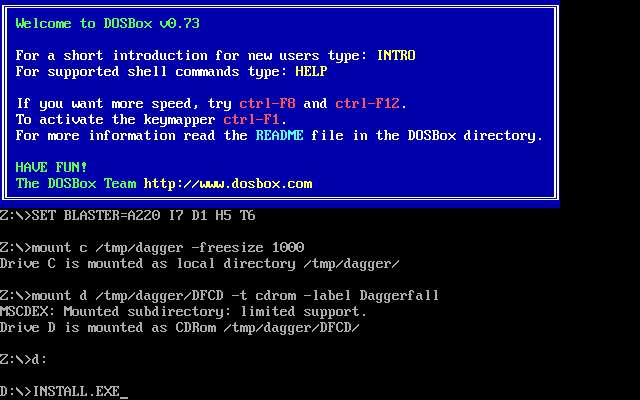

Alright the install guide tell me to mount DFCD as a cdrom but I'm not supposed to do that?

you typed the label correctly ? The capital D is important here

Reply 26 of 29, by Kvnt
Of course, I know this much.
It was mounted correct, absolutely perfect - I realised after I ditched Windows and went on to learn about Linux that capitalisation is important.
So yes. I did. I did it correctly thrice. Reinstalling. Everything.
But I keep getting CauseWay error 01.

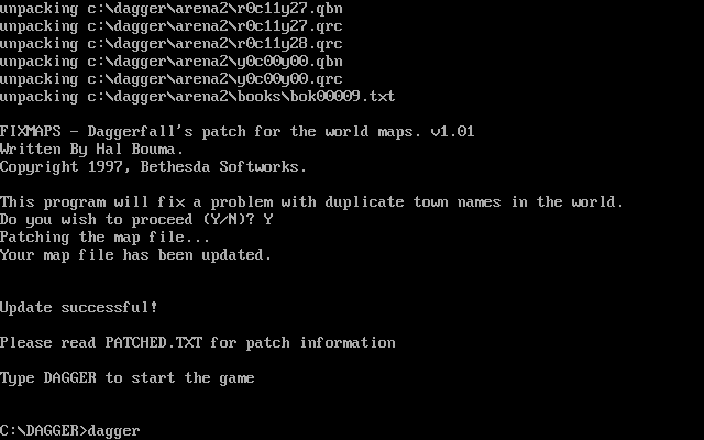

I use the default configuration of DOSBox. So I didn't change that memsize=32 thing

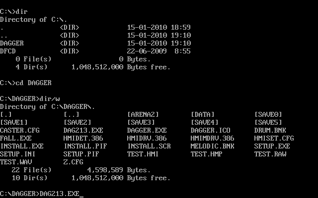

Mounted the paths as visible in the screenshot
selected huge instalation.
Instalation took a while

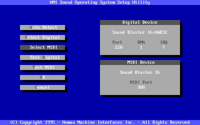

Configuring the sound. Next shot.
Installing the patch Next shot.
Starting the game.
    6.54 KiB
    1339 views
    screenshot 1
    4.75 KiB
    1339 views
    sound setup
    6.18 KiB
    1339 views
    patch
