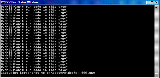

Hi
Shadow Warrior freezed after I defeated the first boss.
I selected 800x600.
The game runs fine if 320x200 is selected but I'd like to use higher resolution.

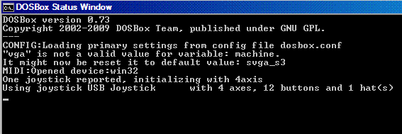

post content of "DOSBox Status Window" before running the game
enclose your dosbox's config file

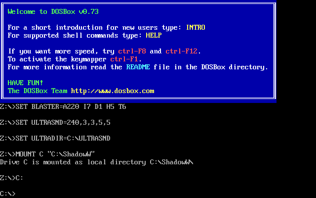

Reply 5 of 12, by nikiniki
where have you got your dosbox from?
The dosbox webpage
what is your Operating System?
windows vista
what are your PC specifications?
Vaio 4gigs, laptop
post your exact mountings
c:\dosbox\dosbox C:\ShadowW -conf dosbox.conf
post what is written after you mounted
see the picture

Reply 6 of 12, by nikiniki
Here the picture
    8.16 KiB
    2196 views
