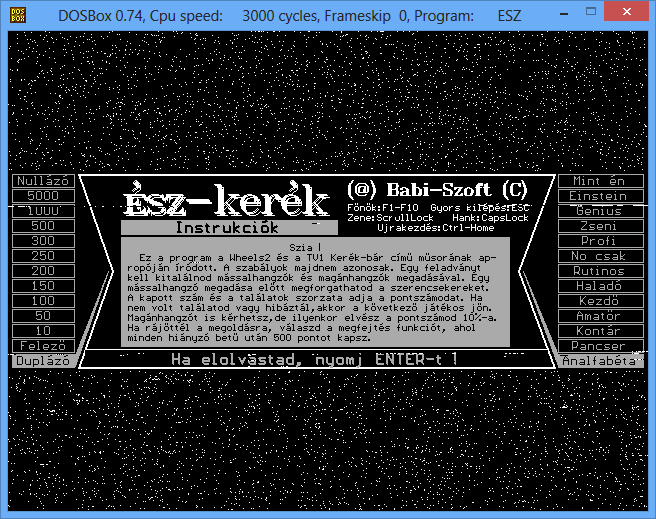

Screenshot of the game running Hercules mode in DOSBox:

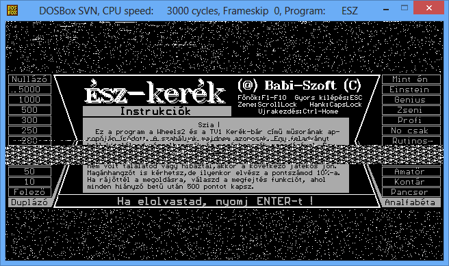

To crash DOSBox all you need to do is press one of the function keys. Of course I'm using the default config file. The result is that DOSBox will hang. Please note that this happens with 0.74 and the latest SVN. Just launch the game, hit Enter a few times and press the Boss key. Here's what the Status Window will show you:
Illegal read from 6e624d6e, CS:IP        0:    82a7

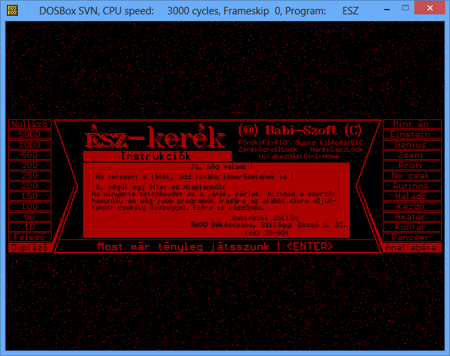

But I got also similar ones with different addresses too. But this is not all. Sometimes I got a black screen too with nothing in the status window. That's not all. I even got graphical artifacts and even sometimes the screen turns red!

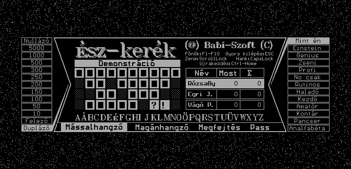

Now here's the catch... if I set the machine type to hercules, cga, tandy or pcjr the Boss key works just fine. It will show you a C:\> prompt on you bottom of the screen. If you wait on the Boss screen the ASCII smiley face will show up letting you know that the game is in the background. All the rest seems to be broken. I tried ega and almost 90% of the screen was messed up. I couldn't reproduce that but I got a similar one caught on screenshot.
