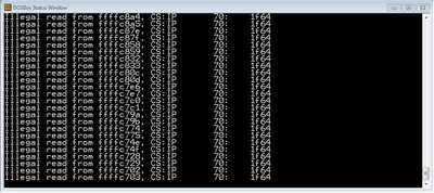

Hey guys, I have a little problem with Settlers 2 (both - standard and gold edition) and ALT-Tabbing. Whenever I want to switch to some other program, while playing S2, I get this debugging error after a few seconds:
I know I'm nitpicking here and I could just play S2 without alt-tabbing, but it's great fun playing S2 in the background while burning DVDs, cleaning your hard drive, writing essays for school, etc 😁 .
I use dosbox 0.72 and other games don't have problems with alt-tabbing. Can I fix this somehow?
Reply 30 of 34, by DosFreak
Can you list the other games that don't have problems?
They probably don't switch to dynamic core which may be why they don't crash.

By the way, my system is: win Vista ultimate 32bit, Athlon XP 2600+, 1,5gb RAM, geForce 7600gt. Here is what Dosbox shows in the back in the status window when the problem occurs, it's one or the other:

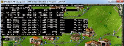

Reply 34 of 34, by kamolot
Hello - It's pretty old topic but i can't fix the illegal read error i have with Settlers 2 gold. The error occurs when i'm in a long play after about 3-4 hours of play. Loading the game again makes it crash almost instantly.
It also gives dos4gw error (screen) Is there any fix for this?

Looks like a game error - Just started this on vm machine with win98se installed - the same thing happened 😒
