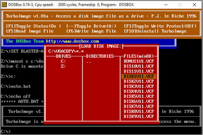

I'm using DosBox 0.74-3 under Windows 10 Pro (without a real 3,5" floppy drive A:\ ) and it works pretty good.
On the other hand I'm using a PC with Windows XP including a real 3,5" floppy drive A:\
The last few days I tried to install Borland Pascal 7.01 (3,5" Floppy Disk Version) and the trouble began.
In REAL DOS, Borland Pascal consists of 11 disks and you have to change them each on drive A:
I want to save each diskette to an image file or something else, because I don't want these floppies anymore.
Then I heard about "Turbo Image 1.01a" a TSR programm to handle many IMAGE-FILES .

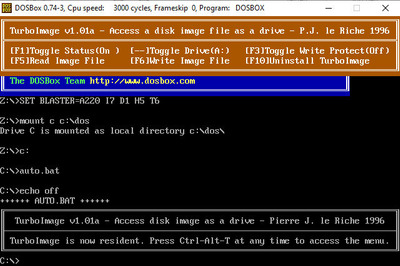

This software is awesome and I love it, (it works in REAL DOS ) but it doesn't serve the drive A:\ right (floppy image loaded by TURBO IMAGE 1.01a) when I hit F1 to activate it.
Under Windows XP with a real 3,5" floppy drive and DosBox 0-74-3, only the real floppy drive A:\ is aivailable , but not the IMAGEFILES, served by TURBO IMAGE.
What can I do ?

Reply 1 of 7, by ripsaw8080
Rank DOSBox Author
DOSBox Author
Use an SVN build of DOSBox, it can mount multiple floppy images (raw format) directly, no need for any other software.
Example command: imgmount a d1.img d2.img d3.img d4.img -t floppy
Pressing Ctrl-F4 switches images. Note that, as in the example, using short filenames for the images is a good idea because you will be mounting a lot of them.
You can get an SVN build here.

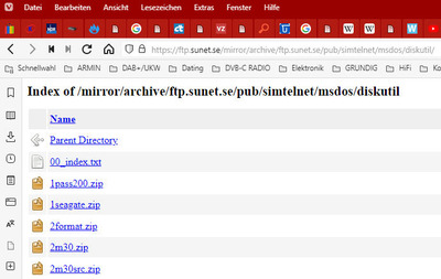

I have found the zip-file with the soucre code of TURBO IMAGE 1.01a (freeware from Pierre J. le Riche 1996)
"https://ftp.sunet.se/mirror/archive/ftp.sunet … util/ti101a.zip"
