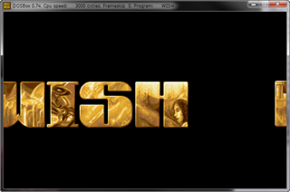

h-a-l-9000 wrote:
An improved version has been in DOSBox source for a long time now. machine=vgaonly
Really 😳
In the Off. Release 0.74 and current svn 3636. Wish logo (and logo roatate/zoom) is not centered. I take from your code "wish_memory2.diff" and added only the missing lines from "vga.draw.cpp" (vga.draw.linear_mask = 0x1ffff)
for Transgression 2 i adapt your hack and it is possible to stretch the screenwidth.
I looked in your Megabuild 5 "vga.draw.cpp" ...ufff 😵 this is completly different to the svn sources.It is possible to make patch for Linewise/Multiscan.
