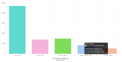

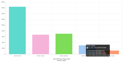

Reply 2191 of 2397, by krcroft
jmarsh, hail-to-the-ryzen - the lookup table suggestion is flying and generating unbiased results to boot. Thanks all round!
Code Explorer: https://godbolt.org/z/f6xddKarf
Google Benchmarks: https://quick-bench.com/q/FO-kOkUG-atr8vmaoJ6KMyW9srM
42.62 KiB
2263 views
GCC 10.2 build with -O2
45.53 KiB
2263 views
Clang v11.0 build with -O2

Reply 2199 of 2397, by hail-to-the-ryzen
If that was set to >127 instead of 128, then i = 128 would access the path for correcting the bias in the conversion. The way it is currently written, the i = 128 results in a table value of 0 which is expected.
