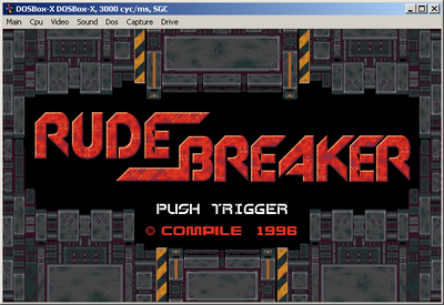

Reply 1270 of 2397, by AnnaWu
TheGreatCodeholio wrote:
BIOS and DOS calls are directly emulated by DOSBox-X (just as it does for IBM PC). No ROM is needed.
You can obtain ANEX86.BMP from various sites that offer the anex86 emulator.
In the latest build, IMGMOUNT has been updated to support mounting FDD/FDI images directly. Make sure you use -t floppy and that the image filename ends in .fdd or .fdi to help DOSBox-X identify that the image is FDD/FDI format.
Thanks for the help, TheGreatCodeholio.
I tried Rude Breaker but unfortunately I have no sound.
Tested on Windows Vista.
If the sound is working please tell me the settings or upload the working *.conf file.
    DOSBox.conf

Reply 1271 of 2397, by TheGreatCodeholio
FM emulation is on by default at the moment. I was not aware Rude Breaker had any sound.
But sound works just fine with Rusty, Edge, Gods, DGA, and Touhou Project here on Linux.
EDIT: All I did for sound was port Neko Project's FM 86-board emulation to DOSBox-X. I did not port the CS4231 emulation. What sound hardware is Rude Breaker expecting to talk to?

Reply 1276 of 2397, by TheGreatCodeholio
AnnaWu wrote:
Thanks for the help, TheGreatCodeholio. I tried Rude Breaker but unfortunately I have no sound. Tested on Windows Vista. If the […]
I just look at what I/O ports are being probed on startup.
Rude breaker seems to check I/O ports 0x88-0x8F and 0x288-0x28F for FM synthesis.
DOSBox-X at this time emulates the -86 board and places it at port 0x188.
Even when I moved the FM to port 0x88 Rude Breaker didn't seem to talk to it, so it probably assumes the -26 board or some other type.
DOSBox-X project: more emulation better accuracy.
