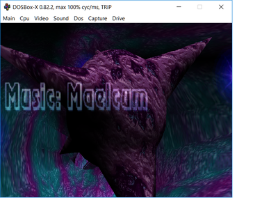

I noticed that when the code DID allow resizing during 3dfx mode, that OpenGL in Windows would somehow work with it but some geometry in the demo (I tested Trip and Nature off of scene.org) would disappear or break.

I added a log window to the async window code base and it would close but the main window wouldn't. I should test the debug window behavior, but I would like to look at the 3dfx lighting issue first. I was just verifying that these secondary windows close in the same way as before.
Reply 1333 of 2397, by hail-to-the-ryzen
I reproduced the lighting issue in dosbox-x for the Trip demo. However, after running the demo on another client in 3dfx/gl mode, then I could no longer reproduce the issue. Attached is a picture for verification.
    619.48 KiB
    898 views
    Trip demo in 3dfx/gl mode on W10 host
Reply 1334 of 2397, by TheGreatCodeholio
So it happens randomly on your system? Seems consistent on mine.

Reply 1335 of 2397, by TheGreatCodeholio
Perhaps there's some initial OpenGL state that the demo or 3Dfx emulation doesn't account for?

Reply 1336 of 2397, by hail-to-the-ryzen
That would be my first guess. There is definitely code in SDL12 and possibly in Windows, particularly in W10, that is optimizing the opengl mode switching. It may optimize it on color depth or another parameter, and this effects the opengl capabilities.
I was unable to reproduce that opengl lighting issue except for the first run in dosbox-x.
Maybe the user could reboot between modes. 😀
