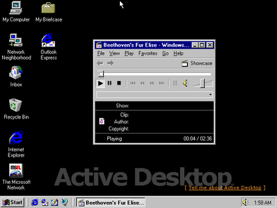

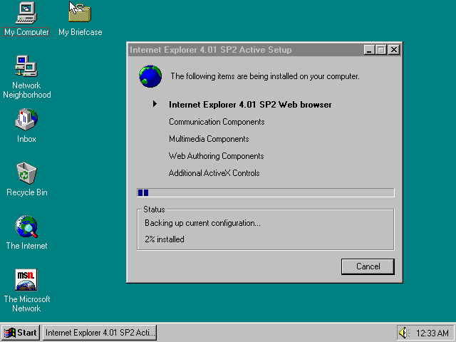

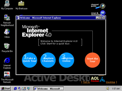

Here goes testing.
Windows 95 original OEM release.
cputype=pentium
cycles=40000
core=normal
10.81 KiB
1535 views
DOSBox-X project: more emulation better accuracy.
DOSLIB and DOSLIB2: Learn how to tinker and hack hardware and software from DOS.
Reply 1796 of 2397, by TheGreatCodeholio
No crash here.
Are you using core=dynamic or core=auto?
EDIT: After reboot, a sudden crash with an FPU overflow.
EDIT: You know what DOSBox SVN and the borrowed x86 FPU code have that DOSBox-X doesn't have? Code to E_Exit() when the FPU stack overflows.
EDIT: Commenting out C_FPU_X86 from config.h and running the startup again seems to resolve the crash.... so far. DOSBox-X bombing out from the x86 FPU core seems to have caused MSIE 4 to fail to create root certificates so it prompts me to confirm installation of each part. But it worked.
