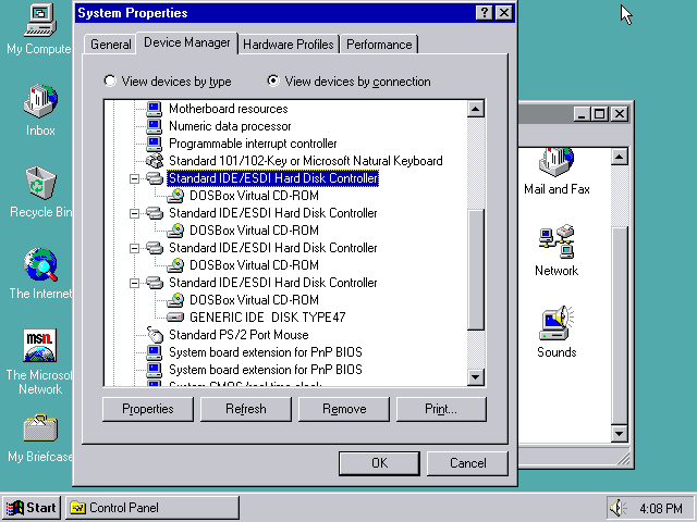

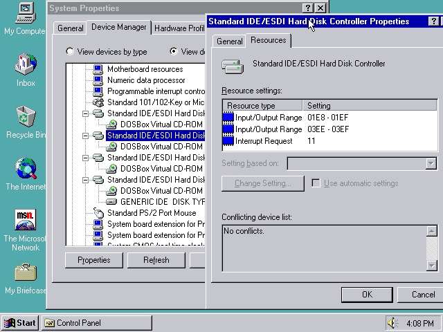

Reply 570 of 2201, by TheGreatCodeholio
Just a quick update: I got Windows 95 to talk to the 3rd and 4th IDE controller by adding the IDE controllers to the ISA PnP BIOS device enumeration. Apparently if the standard IDE driver gets the description from the PnP BIOS it will use whatever I/O port it is told to use instead of restricting itself to 0x1F0/0x170 in the non-PnP case.

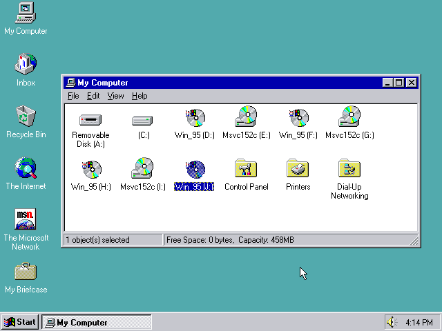

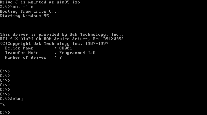

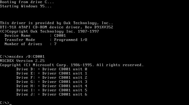

Reply 571 of 2201, by TheGreatCodeholio
OK: Attaching two CD-ROM ISOs to each IDE controller (except the first), yields 7 CD-ROM drives visible in Windows 95.
Is that enough for your game to run? 😀
imgmount 2 hdd -t hdd -fs none -size 512,63,128,1020 -ide 1m
imgmount d: win95.iso -t iso -fs none -ide 1s
imgmount e: msvc152c.iso -t cdrom -fs none -ide 2m
imgmount f: win95.iso -t iso -fs none -ide 2s
imgmount g: msvc152c.iso -t cdrom -fs none -ide 3m
imgmount h: win95.iso -t iso -fs none -ide 3s
imgmount i: msvc152c.iso -t cdrom -fs none -ide 4m
imgmount j: win95.iso -t iso -fs none -ide 4s
boot -l c

This looks great! So far I've been able to add drives 3 and 4. I'm getting stuck on 5 and 6. Dumb question -- can I use any non-conflicting settings or should I try to use yours? I'm guessing the former?

You will need the latest commit that I just pushed, and then you will need to enable the teritary/quaternary IDE controllers (they are now disabled by default unless you enable them). After that, any non-conflicting settings should work. That includes the IRQ---Windows 95 won't touch it if the IRQ conflicts with another controller, or any other ISA device. For the teritary and quaternary stick with the default base I/O 1E8/168 and IRQ 11/10 and it should work.

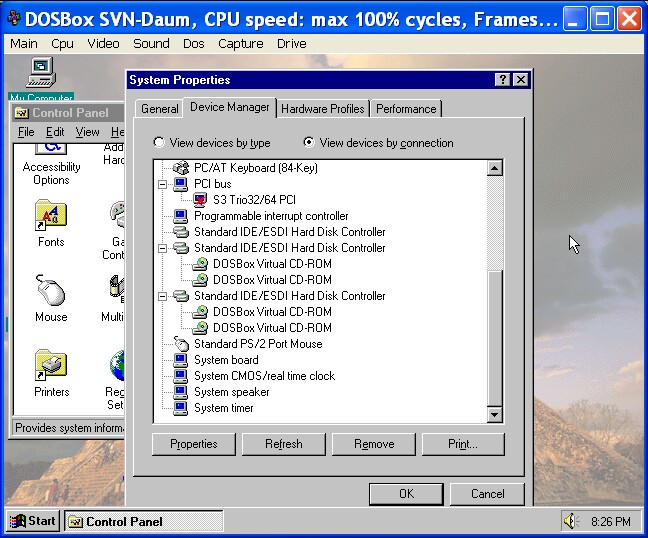

Reply 574 of 2201, by apollo18
I'm using the daum build from January. I'm guessing I have 4 CD-ROMs because I'm using only the first two controllers, right? I would need to use your build to enable 3 and 4?

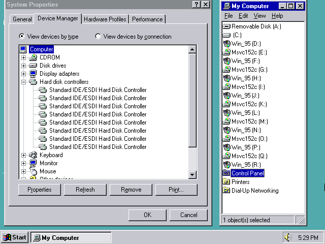

Reply 575 of 2201, by TheGreatCodeholio
Yes. The code has been there for the 3rd and 4th IDE controllers, but Windows 95 ignores them by default. What I did just now to make them work with Windows 95, is add code to enumerate them when Windows 95 calls the ISA PnP BIOS. Windows 95 will only pay attention to the 3rd and 4th IDE controllers if told to by the PnP BIOS.
On a related note, the latest push increases the IDE controller count to 8, and the CD-ROM drive count to 16.
You have to do some sacrifices like removing parallel and serial ports to free up enough IRQs, but it's possible to have 8 IDE controllers now.
Unfortunately, beyond the first 4 IDE controllers the MS-DOS CD-ROM driver I'm using doesn't bother to detect them, but Windows 95 is able to deal with it.
[ide, primary]
enable=true
int13fakeio=true
int13fakev86io=true
cd-rom spinup time=0
cd-rom spindown timeout=0
cd-rom insertion delay=0
[ide, secondary]
enable=true
int13fakeio=false
int13fakev86io=false
[ide, tertiary]
enable=true
int13fakeio=false
[ide, quaternary]
enable=true
int13fakeio=false
[ide, quinternary]
enable=true
int13fakeio=false
irq=9
io=140
altio=148
[ide, sexternary]
enable=true
int13fakeio=false
irq=7
io=150
altio=158
[ide, septernary]
enable=true
int13fakeio=false
Show last 37 lines
irq=4
io=130
altio=13C
[ide, octernary]
enable=true
int13fakeio=false
irq=3
io=120
altio=12E
[autoexec]
# Lines in this section will be run at startup.
# You can put your MOUNT lines here.
imgmount k: msvc152c.iso -t cdrom -fs none -ide 5m
imgmount l: win95.iso -t iso -fs none -ide 5s
imgmount m: msvc152c.iso -t cdrom -fs none -ide 6m
imgmount n: win95.iso -t iso -fs none -ide 6s
imgmount o: msvc152c.iso -t cdrom -fs none -ide 7m
imgmount p: win95.iso -t iso -fs none -ide 7s
imgmount q: msvc152c.iso -t cdrom -fs none -ide 8m
imgmount r: win95.iso -t iso -fs none -ide 8s
boot -l c

Again, Daum's build is based on an older version of my IDE code and it lacks a lot of the improvements I've added since.

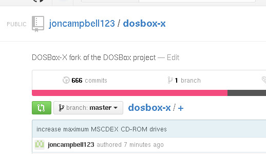

Reply 577 of 2201, by TheGreatCodeholio
Hahahahahaha! And BTW, that was commit number 666!
I just noticed that.
Hopefully my branch is not cursed by the Number of the Beast.
