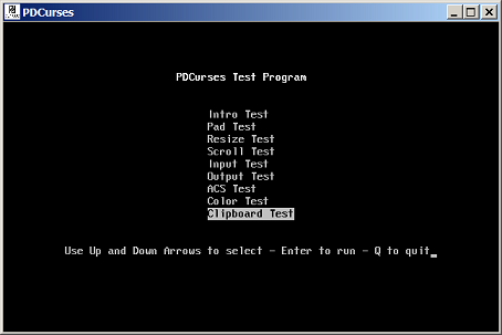

#define HAVE_CLIPBOARD 1
The clipboard functions are in /sdl1/pdcclip.c and the testcurs binary tests those functions:
20.45 KiB
2439 views
Image of testcurs program
Verify that curses.h includes the clipboard functions, such as PDC_clearclipboard. If the curses.h isn't from pdcurses, then most likely these functions are missing. I would use the curses.h that is in the patch, but if it fails on OSX then replace these lines in curses.h:

Under OS X, I built curses (in the sdl1 folder) with #define HAVE_CLIPBOARD 1, and the clipboard test fails - nothing goes in or out.
The curses.h in the PDCurses folder is of course the pdcurses version. I found the ncurses version in usr/include/curses.h but haven't tried replacing it with the pdcurses version. I'll try this tomorrow unless anyone warns me against it.
Reply 68 of 151, by truth_deleted
Pdcurses-sdl must use the pdcurses curses.h file, not another; one reason is that the clipboard functions are not expected in other libraries, but moreso because it will break pdcurses. The /include directory must have header files which match to the linked libraries, especially on OSX.
If running the clipboard test, show the results because they are not easy to interpret (specifically show the final screen that appears from that test). There is no such error I read in source code which outputs "nothing goes in or out" or prints lines that the user copies to the system clipboard. Also, run other tests to verify whether any of the other pdcurses-sdl functions are working.
Report the name of the file modified with: #define HAVE_CLIPBOARD 1.
In addition, if there are any future errors about undefined PDCEX, ensure that this line appears in the pdcurses version of curses.h and it is "seen" by the compiler:
# define PDCEX extern
The above definition line is necessary to define global variables, otherwise pdcurses-sdl will break. This issue doesn't apply to other operating systems and is specific to pdcurses-sdl on OSX.

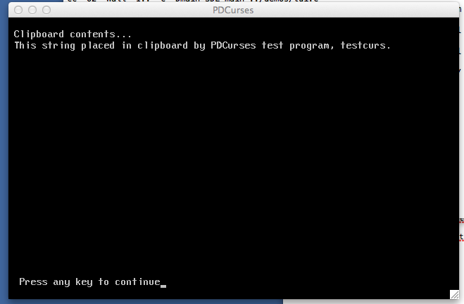

I may have misinterpreted the results of the clipboard test. When I first run the clipboard test (in other words, when I launch testcurs and immediately run the clipboard test it reports "there was no text in the clipboard" though in fact I had placed text into the OS X clipboard.
Then in the next screen it puts it says it will place the following string, etc., in the clipboard, and the string is "This string placed etc."
If I then run the test a second time (without exiting testcurs, it tells me Clipboard contents: This string placed [etc.].
However if I try to use Cmd-V in any other application, that sample string is NOT in the OS X clipboard; the clipboard contains the same text that was there before I launched testcurs. But evidently it was in whatever clipboard testcurs was using, because it found that string when I ran the test the second time (as described in the preceding paragraph).
The file that I modified with #define HAVE_CLIPBOARD 1 is testcurs.c. Before I modified that file, the clipboard test did not appear in testcurs.

The last screen of the clipboard test (testcurs) is still not shown, therefore the final outcome of the test is unknown. However, the above report is consistent with the clipboard functions working in OSX pdcurses-sdl.
Also, the Cmd-V operation is not part of this clipboard test and does not substitute for the final screen of the above clipboard test.
Reply 74 of 151, by emendelson
Apologies for neglecting the screen shot. I think this is what you're asking for. If not, let me know and I'll post another one.
    24.14 KiB
    2408 views
