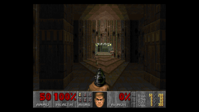

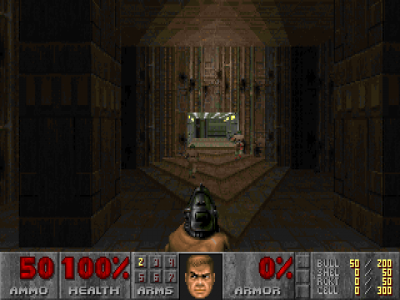

Hey folks, I'm running the latest DOSBox ECE and testing DOOM II.
I have a few questions, so there is this "source port" called Crispy Doom that is a fork of the accurate port called Chocolate Doom.
So acording to the https://doomwiki.org/wiki/Aspect_ratio"This meant that the 320x200 display, with a 16:10 logical ratio, was stretched vertically - each pixel was 20% taller than it was wide". Crispy Doom seems to do this type of correction.
But this patch renders it a little different, like a little bit more stretched.
Now I'm curious, which one the "right one"? Or is there no difference?
    74.78 KiB
    3217 views
    Crispy Doom
    322.97 KiB
    3217 views
    DOSBox ECE
Reply 709 of 733, by Ant_222
Soothe wrote on 2020-01-09, 19:05:
So acording to the wiki "This meant that the 320x200 display, with a 16:10 logical ratio, was stretched vertically - each pixel was 20% taller than it was wide". Crispy Doom seems to do this type of correction.
Cryspy Doom is playing a trick on you by forcing the aspect ratio to the required 4:3 by means of nearest-neighbor interpolation. It is not pixel-perfect. My patch, on the other hand, enlarges all pixels in the same scale of 4:5, so it is pixel-perfect but slightly off the right aspect ratio—because the correct pixel proportion is 5:6. With your resolution it is a matter of compromise: either you get pixel-perfect magnification or the exact aspect ratio. If you had a monitor of at least 1600x1200, my patch would give you both pixel-perfect magnification and the exact aspect ratio.

Reply 713 of 733, by Soothe
Ant_222 wrote on 2020-01-09, 21:29:
Zoomed to check and you're correct. Thanks for creating this patch, seems like a bunch of software isn't doing aspect correction + pixel perfect correctly.
None that I know of. I even have to run ZX Spectrum and SNES emulatros from within DOSBox!
Wait SNES emulators?
Even stuff like bsnes / higan isn't doing it correctly?
Have you ever tried using something like RetroArch?
