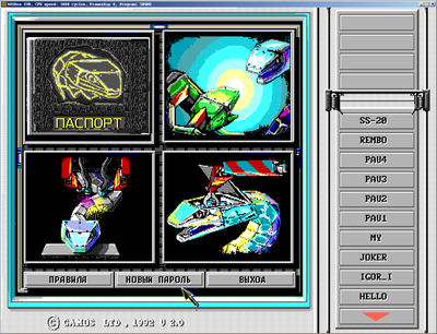

Reply 169 of 733, by Ant_222
James-F wrote:
When overlaynp-sharpness=0, the interpolation algorithm is extremely slow with fade-ins and fade-outs.
This is noticeable in music stutters when there is a fade to black effect in games.
Right, which is why I said it needs further optimization. Zero sharpness means a maximum of interpolation, fade-ins and fade-outs require redrawing of the full frame, whence the CPU load.
It happens only in fullscreen when the algorithm actually works, not in windowed mode.
overlaynp should work, and does for me, in windowed mode as well. If you make the window the size of the desktop it should be slow too. Edit: See, for example, the attached screenshot from Battle Snake in a 1500x1000 window. It is near-perfectly interpolated.
    348.87 KiB
    1155 views
    Battle Snake, overlaynp, at 1500x1000
