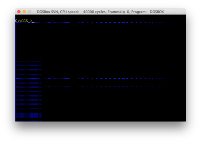

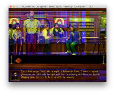

Reply 357 of 733, by Solanacean
I'm having a weird problem with my OS X build when using any of the pixel-perfect modes, see the attached screenshots. Any ideas what could cause this and how to fix it?
Reply 358 of 733, by Ant_222
Not yet, but it looks like a bug in my patch. Does it happen in fullscreen too?
