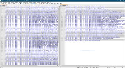

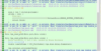

Reply 117 of 142, by Yesterplay80
Still, something seems to be not quite right with your patch. It won't apply here, also and probably because it tries to change a lot more files than the previous ones (see first picture) and even undoes changes introduced before, for example in SVN r4266. Changes that have nothing to do with audio at all (see second picture). 😕 Or am I using it wrong?

Reply 118 of 142, by krcroft
Argh; looks like my master branch has fallen behind in my SVN repo, and thus the diff against a fresh download of the dosbox source then attempted to revert any differences.
I'm focusing on using dosbox-staging as my baseline going forward, and it was used to create the rev12 diff but the patch generation had issues too (likely something I didn't do right in the diff). I will dig in tomorrow and sort it out.
I might try to move toward providing a link to githubs branch differencing tool that uses git to generate the diff on the fly. That will eliminate much of the manual steps I've previously needed to do to prepare a patch (and can be a source of human error)
