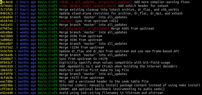

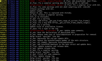

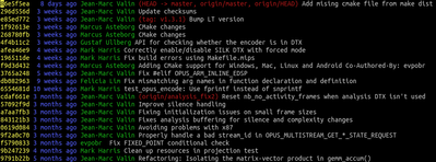

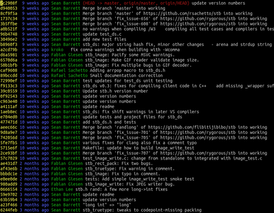

Reply 72 of 142, by krcroft
Revision 9 Updates
This is a maintenance release without function changes.
Under the hood things to continue to improve both in what I'm working on the DOSBox side (comments, warnings, etc) and especially within the one-header-file packages this patch uses and includes. See the changelogs below.
Pro-tip for FLAC users: after ripping your cd-audio to FLAC, add rapid seek-points to your files with metaflac --add-seekpoint=1s track.flac
You will gain instantaneous track seek times when playing games that use one-big music file and jump around within it - like Jones in the Fast lane by Sierra and Stellar 7 by Dynamix.
The screenshots below summarize the improvements made between the last patch release and this release. All changes are integrated into this new patch.
Downloads:See the first post for the new patch which applies to DOSBox r4222 (use -p1) along with Linux and Windows 64-bit static-binaries. If someone wants a new OSX binary, let me know!
