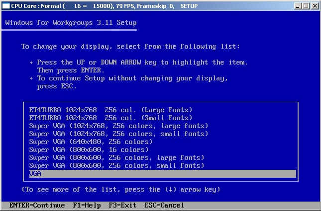

I have one correction/addition to the thread in "Guides" forum, the one about Win3.1x -- cannot post there so just doing it here. The thread should mention that WFW 3.11 had "universal" SVGA driver included and that one seems to be working with my patch. I am still trying to figure how to get WinBench 96 running (seems to have quite a few dependencies: VFW, fonts, etc.) to check if there is any benefit of running "Turbo" driver. It was faster on the real hardware but DOSBox may have different timing behavior.

There is an inofficial patch at http://www.japheth.de/dwnload1.html (bottom of the page) to make the svga driver display 256 colours. Might be worth checking out.
Vasyl: I made the change to the guide, but should now mention that the normal one only displays 16 clours 😀
Reply 138 of 343, by vasyl
WFW 3.11 was more advanced in that respect. The supplied SVGA driver supported 256-color modes up to 1024x768. Just check the screenshot. I am sure that Win 3.1 did not have that.
