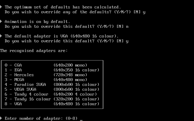

You say that Wonderland uses VESA. Are you sure? I think it is just a non standard SuperVGA.
By the way - It seems to be the oldest game using SuperVGA (1990). The manual says that the option SuperVGA in setup is for "Video 7- and Paradise-compatible" cards. May this mean that these two svga cards are the oldest SuperVGA game standards and that's why the most compatible with games?

robertmo: I've got Wonderland to install (in VirtualPC using disk images). There is something very odd about SVGA modes that it supports. The setup refers to Paradise and VESA but in 1990 VESA was not approved yet, in fact, it was not in common use until 1994. However, the manual refers to Paradise and Video7 which makes much more sense for UK-made game from that year. My guess is that either Video7 was one of the founding members of VESA committee and somehow confused people with that or there was some popular Video7-based card called VESA (just like some games referred to Diamond when in fact they supported generic S3 chipset). Well, here's another argument for modular SVGA support. I can add some basic Paradise or Video7 support after I deal with some Tseng intricacies.

😊 Oops, I should've been paying more attention. Apparently, I've read only the first two characters and them my tired brain "reconstructed" the rest. Now it all makes sense, VEGA was indeed a name for Video7 chipset.
All right, so Wonderland does not work yet. I don't expect it to push on hardware too hard, so basic Paradise or V7 implementation would suffice. I'll put it on my todo list. So, which one first -- Paradise or V7?
