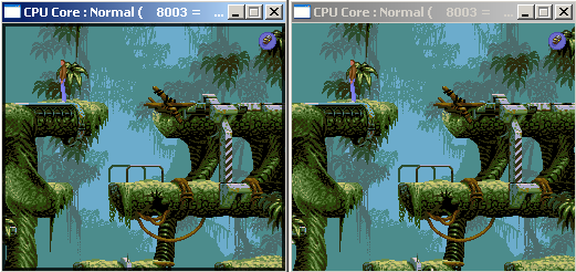

It adds a border to Flashback, but it is not how the game should look - the result is that you don't see the whole picture.

I was afraid of something like that. It means that the game sets non-zero border color but it still black and carries no useful load. Two possible solutions: detect complete (or nearly complete) black and ignore it as well OR set no border as DOSBox default because it is only needed by a handful of games. In ideal case, shortcut key -- I just did not want to touch that part of the code until the feature gets debugged and proven.

About border appearing when not needed:
- robertmo: Should have saw that coming (but didn't)... Good catch!
- If you have blending enabled and set the thickness to be small, it shouldn't be too distracting (I'd hope)
- Could just make it disabled by default and add a note to the docs about how to turn it on for games that need it, but then you might be missing out if you don't know that a game you're playing uses that feature
- A hotkey is probably the best solution, as vasyl suggested. This would make it feasable to have overscan border emulation enabled by default because it would be easy for the user to toggle off when it's too distracting or not needed
- I think detecting "near-black" is probably a suboptimal approach, as some games may actually have a use for black border color. Also, some games may set useless border colors that are nowhere close to black. I spent a few minutes trying to come up with other fancy ways of detecting useless borders, but couldn't think of anything that is likely to work. Doesn't mean there isn't a slick way I haven't thought of though...
