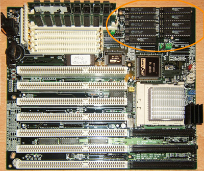

On a 486:
The CPU has cache memory called L1 (level 1). It can be 8KB or 16KB depending on your CPU. Earlier ones have 8KB, later ones 16KB.
The motherboard may or may not have cache memory, called L2.
According to the link you posted, your motherboard does not have L2 cache. So you don't have to worry about that.
A board with L2 cache usually looks like this:
1009.26 KiB
96 views
Those are DIP-28 SRAM modules.
According to the size of your L2 cache you can cache your motherboard's RAM. That means it would work a little bit faster.
And you don't really have to worry about L2 cache for a 486. Upgrading the CPU is far more important if you want a faster 486, the BUS speed and waitstates are also very important.
Disk drive caching is a different subject.
