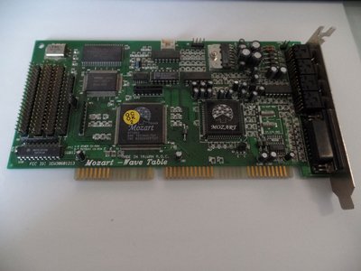

This.... Look's kind of interresting. Does anyone know how it sounds?
124.27 KiB
1552 views
Reply 14438 of 52909, by brostenen
