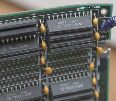

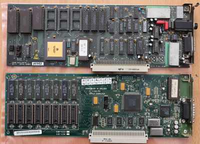

Reply 33444 of 52951, by Predator99

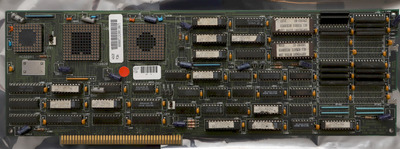

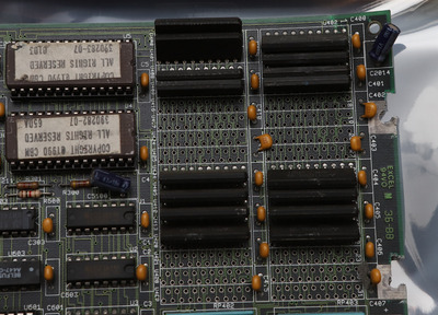

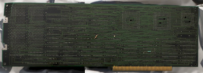

Some of my parcels already arrived...the MAC cards are looking good:
1.54 MiB
1654 views
The A2000 Turbo-card not so good. It was on the bottom of the box with 10 kg of junk on it 🙁 It seems the card has more than 2 Layers? Some of the pins of the ZIP-RAM on the top are neither connected on the bottom nor on the top side of the pcb?
I will check the connections, but for me it does not seem to be very repairable. And I would have to invest around 75€ for the missing ICs to make a test....

Reply 33446 of 52951, by brostenen
Predator99 wrote on 2020-04-16, 20:34:
Some of my parcels already arrived...the MAC cards are looking good: IMG_8840r.jpg The A2000 Turbo-card not so good. It was on t […]
Oh... That is a shame with the Amiga 2000 card.... On the mac card's. Right above the Toshiba chip on the video card..... Are C3 not missing?

Reply 33449 of 52951, by imi
brostenen wrote on 2020-04-16, 20:28:
Ohhhh...... That is a sweet thing. 😜
oh yes it is :3
I just read that it is running a TX486DLC/E-40GA inside ^^
I don't think it is a multilayer PCB as such, but there might be a ground plane in the middle (dark area?)
all pins but four are connected on the topside from what I can see, I couldn't find a pinout for the zipram quickly.
if it is indeed just a groundplane in the middle and none of the pins are shorted out at the break area it could be repaired I guess.

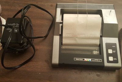

Reply 33451 of 52951, by Hamby
I've had two Commodore 1520 plotters for decades.
IIRC they have problem involving the pen holder holding the pens against the paper properly.
But, for those decades, I've wanted to be able to connect them to my various PCs.
Time and again I considered trying to adapt them to PC parallel ports.

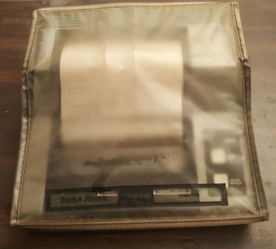

Then I discovered that the Tandy CGP-115 was essentially the same printer, and had a standard PC parallel port!
Well, I finally broke down and bought myself one on Ebay. It came with a dust cover; had to buy the power supply separately, though.
105.12 KiB
1649 views
56.01 KiB
1649 views
Haven't hooked it up and tried it yet, cause I need to dig some plotter pens out of my closet.
Hopefully they haven't dried out.
I did spray everything with isopropyl alcohol; interestingly, when I tried wiping it off, it seemed to take the paint off the silvered sections, leaving them a lighter shade of silver. I'm hoping this was just oxidation.

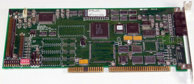

Reply 33454 of 52951, by cyclone3d
Doing a search with not my normal terms brought this up and so I bought it:
386.16 KiB
1576 views
It is a Cardinal Sound Studio. Should be Adlib Gold compatible.
See this thread for a bit more info:
Dune recordings by alex.schroedsen
I'll take some proper pics of it when I get it and maybe do a mod to add RCA plugs like in that other thread.
Anybody have the manual or official drivers for this thing?

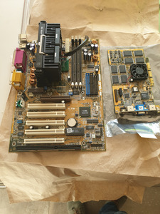

Woohoo! My first K7. I always had the impression that they were almost impossible to come by in Belgium.
I finally got one, a 750, and on the right mo/bo as well, the Asus K7M. Seller threw in an Asus TNT2 Ultra for my offer of 25 euros.
Back in the day I had to settle for a TNT2 M64, and that already costed me 5990 BFR (taking inflation into account, about € 225).
1.77 MiB
1536 views
GPL-2.0-or-later
Reply 33457 of 52951, by Skanque
flupke11 wrote on 2020-04-17, 07:55:
Woohoo! My first K7. I always had the impression that they were almost impossible to come by in Belgium. […]
Awesome combo, you won't be disappointed with the ASUS V3800 Ultras performance
