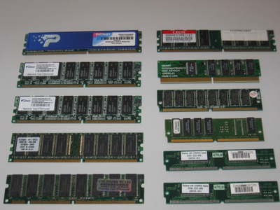

Bought a bunch of stuff from ewaste today ($5 each for cards and the floppy drive, $10 for the P2B). My source doesn't remove brackets but unfortunately the person that they got these batch of cards from does 🙁 Very happy about the Powerleap, it's beat up but repairable.
Also bought a bunch of things last week from the same place including a Voodoo4 PCI and Voodoo3 1000 agp, 2 TEAC FD55-GFR 5.25 drives, FIC 486-PIO2 and another 486 board (more pics of those to come) for $5 per card and $10 per mobo.
Reply 39169 of 53139, by vetz
Nice, I see a RealMagic Rave card there (Trident + RealMagic MPEG decoder VLB). Rare to see a photo of it!

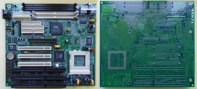

I'm not much for skt 7 stuff, but saw this at the weekend as bulk NOS...a Lucky Star 5MVP3 v2.1. Anyone know the latest BIOS for this version - I updated it to au6-3 which seems to be the latest for v2.x boards listed by LS on archive.org, but there are later versions for v4.x boards. Do they work too (seen comments online that there may be issues using these)?
