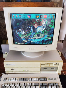

Reply 47607 of 53151, by kohellus@gmail.com
Ensign Nemo wrote on 2023-01-15, 18:27:
kohellus@gmail.com wrote on 2023-01-15, 08:26:
Bought this a few months back. It took a long time to arrive and it took a long time for me to get time to know the insides of it 😀
I know guys who like to read in the bathroom, but computing is a whole new one (-:
Lol It has the best lighting and its the most uncluttered room i have for bigger projects, including reading 😁

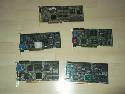

I got a bunch of dead voodoos from a colleague who was sort of promising to trade them for some time. I think bellow 100EUR was a good deal but I'm feeling buyers remorse already.
file.php?mode=view&id=155175
Some aren't in factory condition and has marks of repair or modification attempts. I haven't examined them thoroughly yet. The one lower right is probably hopeless. Diagnosing them will be some time consuming thing....

DAVE86 wrote on 2023-01-16, 17:33:
I got a bunch of dead voodoos from a colleague who was sort of promising to trade them for some time. I think bellow 100EUR was […]
What kind of colleague would ask 100 euros for crippled and/or abused cards. That is looking fubar.
Reply 47614 of 53151, by TheAbandonwareGuy
PD2JK wrote on 2023-01-16, 21:21:
TBF 100 euro is basically what a single working V1 goes for.
The good thing is Voodoos don't use any BGA chips, everything has pins/legs. Which means with proper skill and good soldering equipment you can swap everything up to and including RAM modules and the TMUs.
For a highly skilled technician, its probably not a horrible deal. If he can fix 3 by cannibalizing the other two, its a hell of deal IMO.
Reply 47615 of 53151, by danieljm
Looks like you've got a couple Voodoo Rush cards there. Not sure if this will help you at all, but I recently got a Voodoo Rush and I was worried it might be broken but it turned out to be just software issues. The 2D was working, but trying to start a game with Glide in DOS was crashing my system. When I jumped into Windows 98 I was getting "out of range" messages on my monitor, but then I tried 3D Mark 99 and it ran just fine. From what I can tell D3D games were fine and it was just Glide games that were the issue. After moving back to version 2.43 of Glide I managed to get games working in Windows. I haven't gone back to try in DOS yet, but from what I understand the Rush doesn't like DOS games, so I'm not holding out hope there.
The other common issue apparently is that the drivers will overclock the 2D chip in Windows and that can lead to garbled text. There's a registry setting you can edit to bring the clock speed down which will fix the problem.
Anyway, hopefully that can help you. Good luck!
Reply 47616 of 53151, by Ozzuneoj
TheAbandonwareGuy wrote on 2023-01-17, 04:29:
TBF 100 euro is basically what a single working V1 goes for. […]
Have to agree here.
Just to pick out what cards are in the lot:
ViewTop 3D Vulcan Voodoo Rush
Hercules Stingray 128/3D Voodoo Rush (Someone seems to have added a cooler; Also, this will have a really huge screen printed logo on the back, which is neat)
Gainward Dragon 3000 Voodoo 2 (Looks to be missing two heatsinks... though I don't see any residue? Either way, these heatsinks are used on cheap SiS and other cards so they aren't impossible to replace)
ProComp G111 Voodoo 2
Provideo Voodoo 2? (Not 100% sure on that. Regardless, this is the only one that looks visibly damaged to me. )
Unless there is other damage to the other cards that I didn't spot, 100 euro is a fantastic price for this lot. Even if you aren't interested in trying to fix the one with the missing chip you'd probably get back a decent chunk of what you spent on this lot just putting that right on ebay for parts. There are not many Voodoo 2s with blue PCBs out there, so someone would certainly buy it to repair if you don't want it.

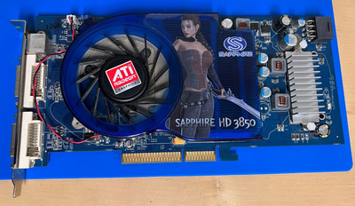

Managed to get this for $20. Feeling very lucky. Unfortunately I don't have a CPU/Motherboard powerful enough to take full advantage of it. 😀
Reply 47618 of 53151, by appiah4
danieljm wrote on 2023-01-17, 07:37:
Grab a Socket 754 motherboard and a cheap high end Sempron. They are still pretty cheap.
Reply 47619 of 53151, by danieljm
appiah4 wrote on 2023-01-17, 07:49:
