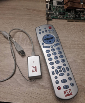

I got an ATI Radeon All-In-Wonder 8500DV with all of the accessories.
The card even comes with a nice, passive Zalman cooler (ZM17-CU) and it seems to have been rarely used, because it smells like a new car and even the ATI Remote does not have any wear on the rubber parts.
601.69 KiB
1949 views
501.14 KiB
1949 views
This is amazing. I'm gonna test this thing out soon - I wonder if the USB-Remote still works on Windows 11 or if it needs special drivers to function. Maybe it'll run on Linux? 😁
The only thing I'm not sure about is this VGA adapter that breaks out into Composite and S-Video. Did that come with the card? It just seems to be a direct cable. I don't think it's possible to adapt VGA straight to these standards, or is it?
108.81 KiB
1949 views
Reply 50822 of 53103, by DerBaum

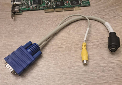

schmatzler wrote on 2023-11-06, 22:54:
The only thing I'm not sure about is this VGA adapter that breaks out into Composite and S-Video....
I have 2 of those... I think they came with Matrox cards...

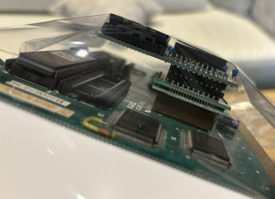

Picked this up for ~65 USD on the streets of Japan.
1.69 MiB
1904 views
1.09 MiB
1904 views
Reply 50824 of 53103, by BitWrangler
Baroque, but what was it a CPU card for in the first place? Or don't you care and are going to use the upgrade on something else?
Reply 50825 of 53103, by ubiq
I got an ATI Radeon All-In-Wonder 8500DV with all of the accessories. The card even comes with a nice, passive Zalman cooler (ZM […]
I had this (or similar vintage) All-in-Wonder and that VGA thing def did not come with it. Looks like you got everything else though. I loved that remote - rf-based, not IR, and it could act as a mouse. 😎

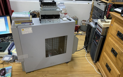

I got this HP 220mx MO jukebox from a friend (because his wife complain about the its size take up much space at home)
and oh boy, that thing is soooo big that it surprise me when i seen it for the first time.
453.89 KiB
1830 views
there are a lot of dust inside the drive, i had to dismantle the MO drive to access the lens to clean it.
at least sony is kind enough to made the pickup unit can be replace without worry about messing up the alignment.
360.68 KiB
1830 views
Reply 50828 of 53103, by liqmat
BitWrangler wrote on 2023-11-07, 02:02:
The upgrade and the price was most definitely the attraction. Not sure what Epson system it came out of, but I’ve had no time to research.

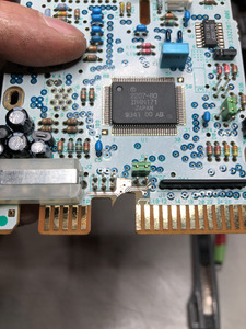

I am surprised that nobody has seen it...
But now i know why the drive was "untested"...Always the same thing with these seller idiots.
Can you see it? I feel so stupid for not seeing it. And now i need to repair this drive too if it is even fixable.
i will need some extremely high resolution reference pictures of a not broken drive.
edit: correction pictures are not enough... i need somebody with the exact same drive who is abled to make 5 or 6 measurments for me...
FCKGW-RHQQ2

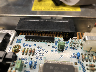

Reply 50832 of 53103, by weedeewee
DerBaum wrote on 2023-11-08, 16:31:
I am surprised that nobody has seen it... But now i know why the drive was "untested"...Always the same thing with these seller […]
DerBaum wrote on 2023-11-02, 16:53:
Because i dont feel confident in finding the failure in the drive i destroyed... i bought another one. […]
DerBaum wrote on 2023-10-08, 21:53:
Now the really bad news.
I think i have killed the 5 1/4 floppy drive...
I bought a very similar model so i can swap the faceplate to the brown one my drive has on it.
The drive i got is untested... wich is not a good sign in general... but it was the cheapest one for 30 euros.
Who the hell decided that a used untested floppy drive is now 30 bucks? depressing...
At least it looks clean...
I think today or tomorrow i have time to test it.
edit: correction pictures are not enough... i need somebody with the exact same drive that i abled to make 5 or 6 measurments for me...
I don't see it looking at the photos.
Any clue ?
Do not ask Why !
Reply 50833 of 53103, by TheMobRules
Broken edge connector?
EDIT: I agree, it's really annoying to have to play "Where's Waldo?" with these sellers and their "untested" items

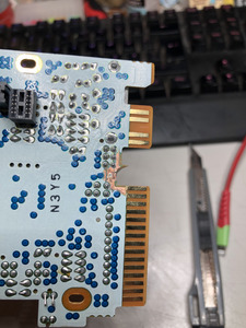

Reply 50834 of 53103, by DerBaum
TheMobRules wrote on 2023-11-08, 17:13:
100 points ... 1 to 4 are missing...
You cant imagine how irritated i was when i wanted to plug it in...
1.39 MiB
1477 views

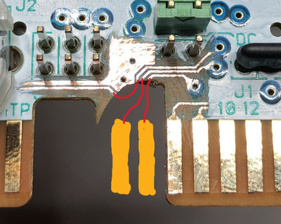

EDIT:
i have started to remove the soldermask to see the traces.
1.32 MiB
1477 views
1.75 MiB
1477 views
the backside is just ground thats easy... on top about 4 traces are gone with the piece of the connector...
my first guess it should look something like this: but i need confirmation first before trying to make a piece to repair it.
255.17 KiB
1466 views
FCKGW-RHQQ2
Reply 50835 of 53103, by TheMobRules
DerBaum wrote on 2023-11-08, 17:16:
I think that extra card edge under the power connector makes it even more confusing, it's easy to miss at first glance... I wonder how compatible this PCB is with the drive from your original post, both are FD-55GFR right? Maybe you can get one working drive out of those two.
Reply 50836 of 53103, by DerBaum
TheMobRules wrote on 2023-11-08, 17:22:
they are extremely different. the original drive has a head loading machanism with an electro magnet and the head is connected by wires also the stepper has wires.
on the newer drive there is no head loading mechanism and everything is flat cables. they are around 5 years apart.
My guess that on the original drive the electronics are toast... but all chips are different from the new one.
Yes the extra connector is confusing. its a test connector presumingly for factory testing.
one of the damaged traces goes to this connector. so i hope that i have to repair one trace less (because i dont care if the test connector works) 😁
maybe i can even cut off the test connector and use it as a replacement part... i have to investigate how i can make pcb or where i can cut off a piece of an edge connector. i also have some donor isa cards like modems or isdn cards.
FCKGW-RHQQ2

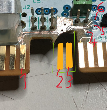

Reply 50838 of 53103, by DerBaum
CharlieFoxtrot wrote on 2023-11-02, 18:36:
I have one 7193-U and it is manufacterd in 1993.
Is it possible that you measure some connections for me?
just beep out some things. nothing fancy
310.84 KiB
1339 views
1 is the Pad on the test connector
2 and 3 are the missing pads
4, 5 and 6 are vias.
I made a small chart of the measurments i need.
1.81 KiB
1339 views
1 to 2,3,4,5,6
2 to 3,4,5,6
3 to 4,5,6
4 to 5,6
5 to 6
Thanks in advance.
I expect:
1 to 6
2 to 5
3 to 4
FCKGW-RHQQ2

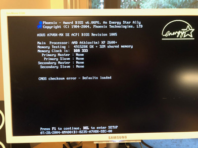

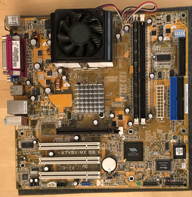

Reply 50839 of 53103, by ubiq
This showed up today:

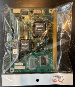

1.35 MiB
1671 views
I tossed $10 at an eBay auction with no bids and ended up getting it. It came with CPU, RAM and a I/O faceplate. Looks like it actually works!
1.3 MiB
1671 views
